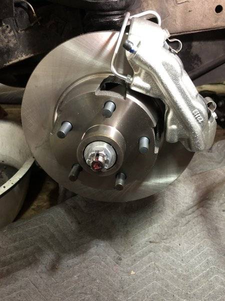

@Red63440 . I am trying to decide between this kit or the Dr. Diff kit. I found this thread and am super interested since our cars are almost twins, and I will also be using a dual master cylinder on my original brake booster. How do you like this kit after having it on for a couple of months? Have you had any problems with it? Thanks, BBD.
My 64>

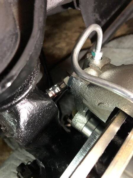

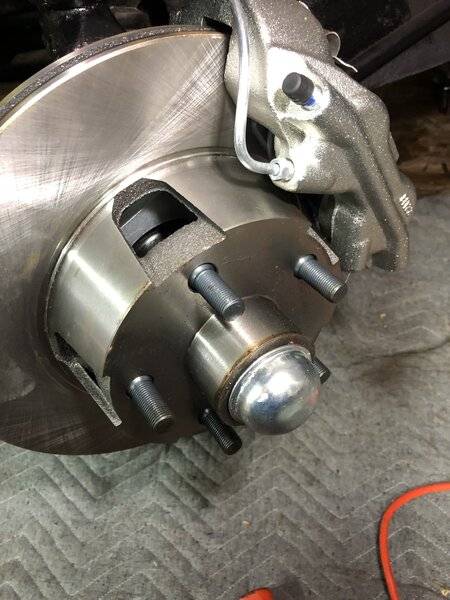

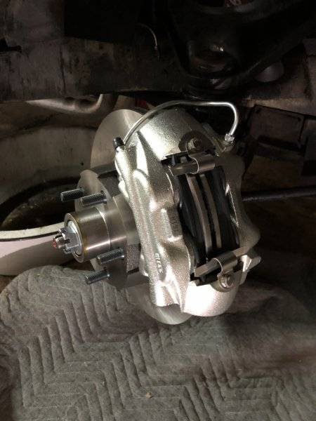

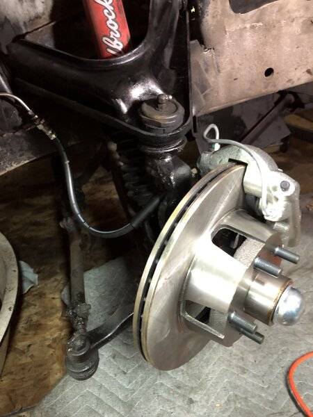

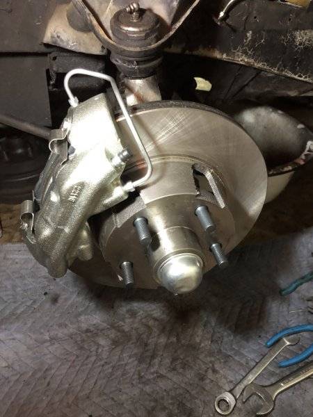

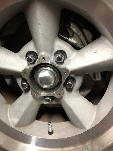

The kit was super simple to install although I did have one problem. I found I had a bent spindle but once I changed that out I was fine. I got the kit with the master cylinder, adjustable proportioning valve and front brake lines and hoses so I had everything I needed. It works fine and I am happy with my choice.
