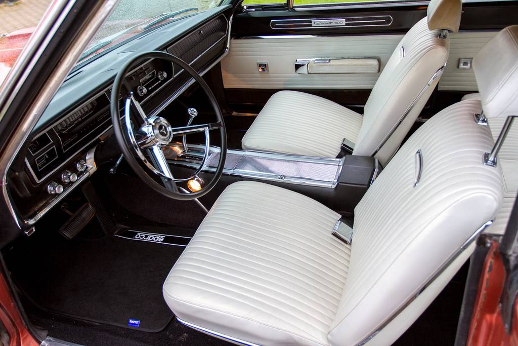

90% certain my '67 Charger has ash trays in all four arm rests, the dash and rear center... I counted 6 once, but I can't find a picture to prove it. Interior is pretty original, as far as I can tell.

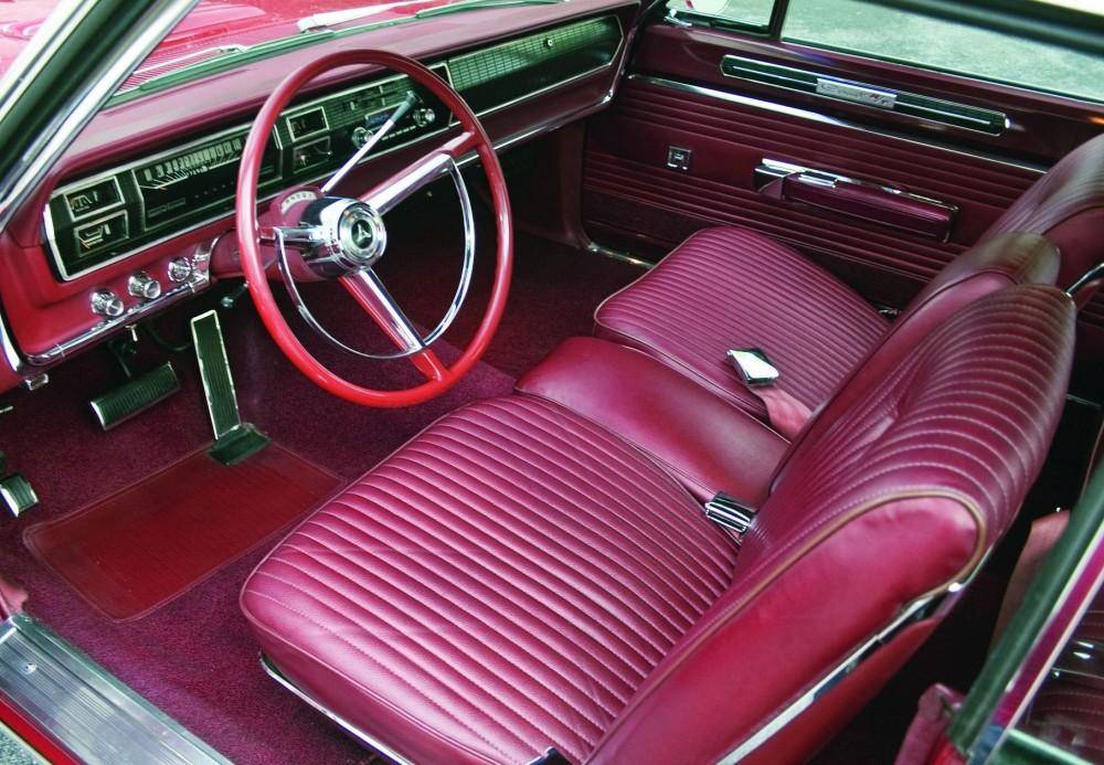

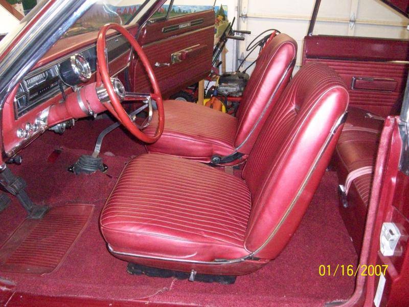

At least I know it was on the Charger, I am wondering if Coronet 500's and R/T's with the premium trim got these too? Can anyone confirm this?

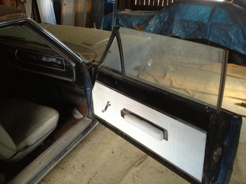

If it helps, here is a picture of a 1967 GTX passenger door. The car is unrestored and, to the best of my knowledge, original inside. Fender tag numbers confirm interior colors, options, etc. As you can see, no ash tray.
Not your car exactly, but is a 67 B-body for reference...
