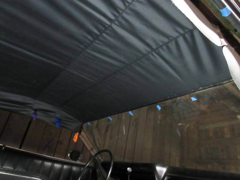

Use painter's tape to mark the locations of all the screw holes. You'll need a bunch of clamps to hold the headliner in place where it glues to the door frame . The kind shown in this picture were too weak, and I didn't have enough of them. I've got a box of the right kind which I'll try to find later.
Have good ventilation. Headliner glue is strong stuff.
I was able to get a good result and did not need to shrink with a heat gun. It took months for the folds to relax and smooth out.
