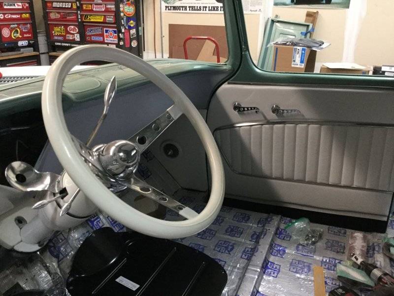

I've used FatMat with good success. In the GTX I used just RattleTrap underneath mass backed carpet. In the '58 I did the entire cab including the doors with RattleTrap then added a layer of FatMat floor liner from the top of the firewall to the back of the cab. With the jute pad, carpet and padded door panels it went from riding in a soup can to almost new car quiet..
