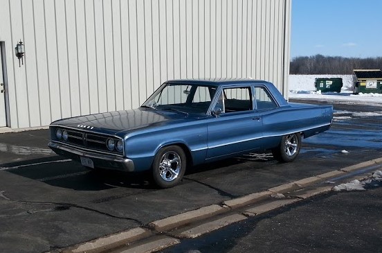

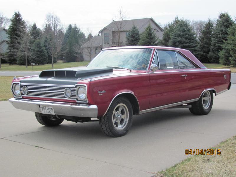

My WO car, when it was ready to come home from the chassis shop...
Lookin' good, man.
Very nice I can't say enough how I love 66 - 67 b-body Mopars I know it's a rarity because she's only two years they made those body styles man that looks good thanks for sharing

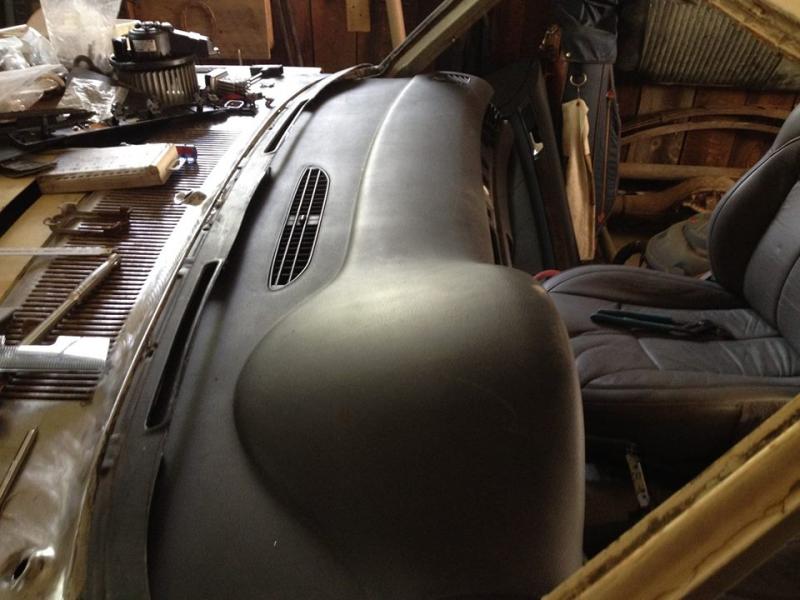

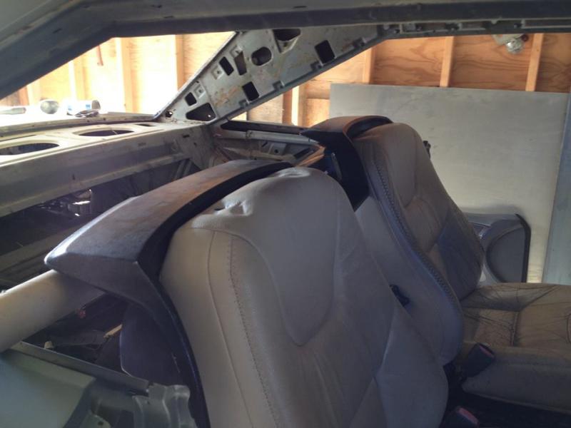

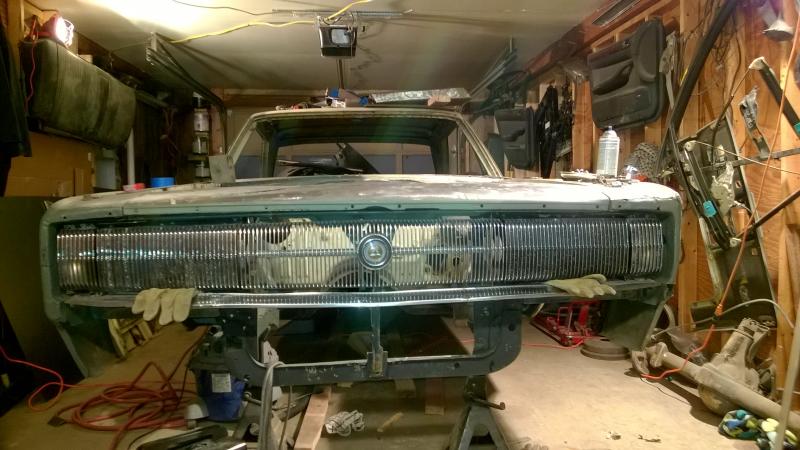

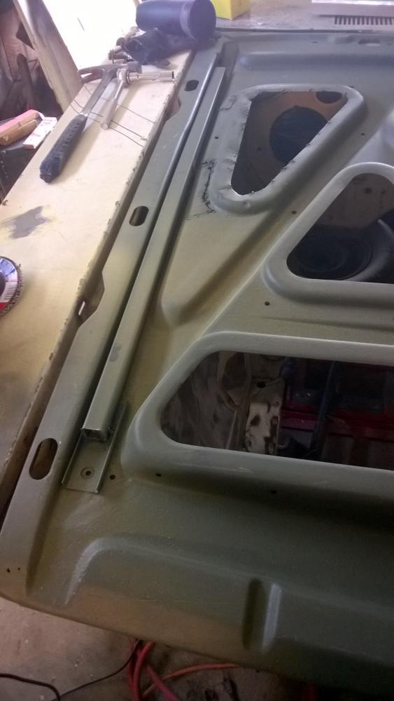

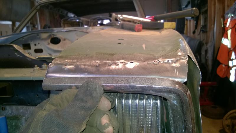

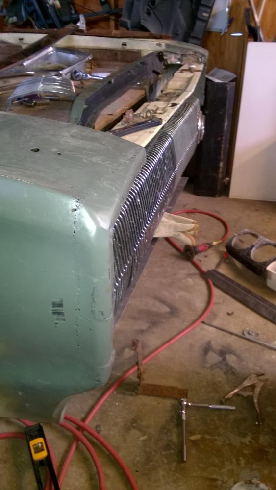

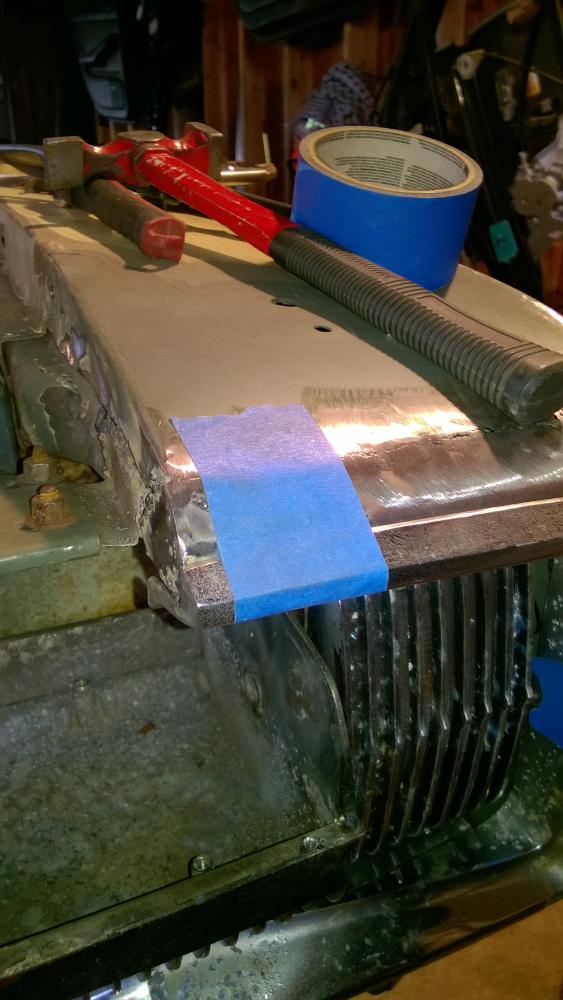

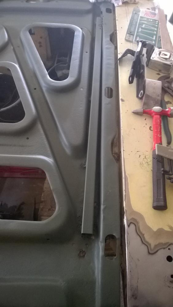

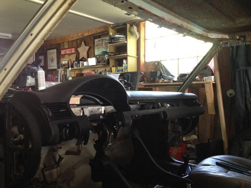

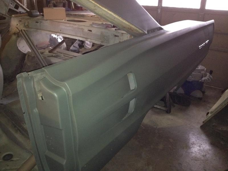

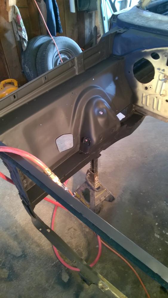

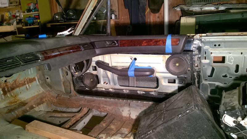

Me too... I have not put up anything in awhile so here is where it is at today.. The 66 T bird tail lights fabrication work is finished, the 66 Charger headlight/grille install is finished, the fender noses being swept back was finished but I tore apart the left side as I was not happy with it and am awaiting parts, 2/3rds of the outside body is sanded and primed, the fake scoops on the quarter panels have been opened up and the lead ins curved down into the body leaving kidney shaped openings that will have Stainless wire mesh to finish,the hood has been separated from the frame and sanded and primed inside and resandwiched, the hood has had stiffener bars welded to both outer edges inside the frame, the hood has been sliced at the front 8 inches to make a header panel, the 2002 Audi dash has been test fitted and the mounts created, one rear well is tubbed, and the interior doors and roadster panel have been mocked up, and the 70 Road runner rear bumper has been widened and fits well, a 65 Coronet bumper is about to be purchased for the front.. All in all it has been a satisfying winter so far.

Those are some wild modifications and must have taken some real imagination and skill to apply. Cant wait to see how it all turns out!
Thanks! I forgot to mention that the exhaust will exit through the back up light holes, the gas tank is in the trunk, the gas lid is recessed into the top of the Qtr panel next to the trunk lid, the trunk lid and hood will be gas lifts and the hood tilts forward. The Audi dash is a complete dash with steering as well and all of the electronics that go with it and the center console w/ e-brake. It has Bose 9 speaker Symphony stereo and CD changer, digital climate control for both sides, and Audi heat and AC. The seats are 2006 Jeep Grand Cherokee 10 way power bucks w/ heat and the brake MC w/ booster and the wiper motor are under the dash. I have a Ford 9 inch for it and the original 8 3/4. Also have a 440 wedge for it and a BB trans.
Wow i want to see more so please keep posting updates this will be a real treat your going in a direction of Modifications i could never do.. GREAT JOB

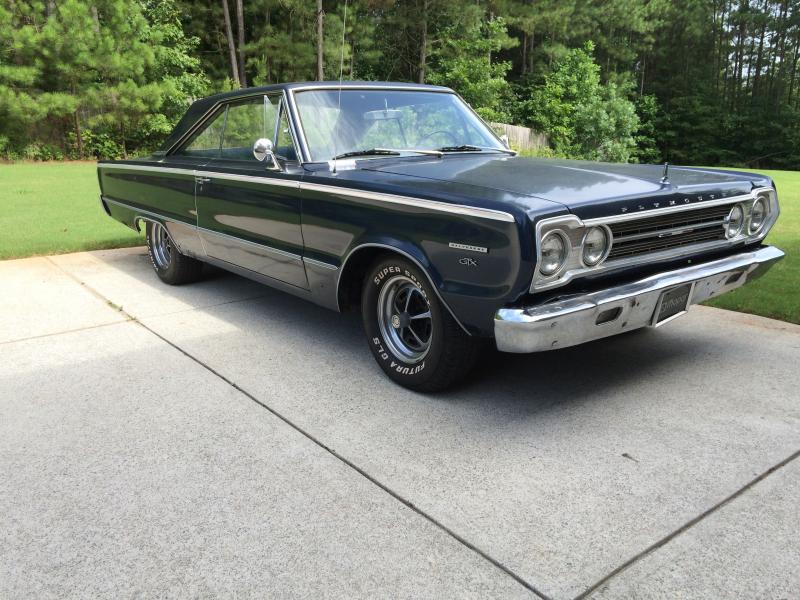

Is that a 66 or 67?
Here's one I never finished. It went to England.
