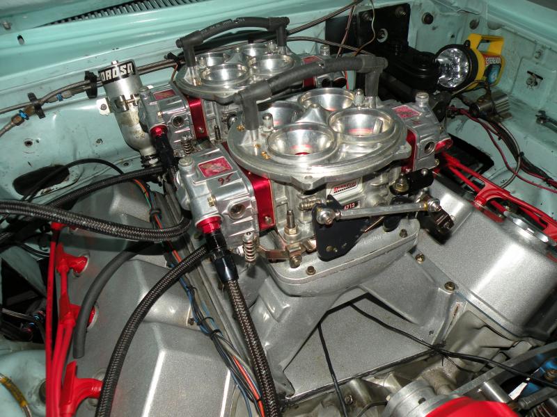

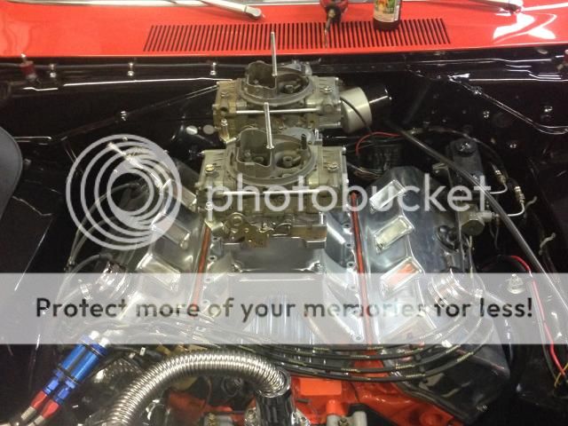

figure without some major changes i've about maxed out the ET on the dart. best its been is 10.30 @ 131. thats with the MP cross ram and the 770 carbs. We tried some 850's on it but the distribution really isn't for crap on that intake. to really get it to be right with the bigger carbs was going to take some distribution dams. So my solution, try the bigger carbs on an intake that shouldn't have any distribution issues. i set it on there last night, looks pretty cool. i'll have to fab up a throttle cable bracket and some fuel lines yet. have to wait a few months before i can see what it really does, if anything.

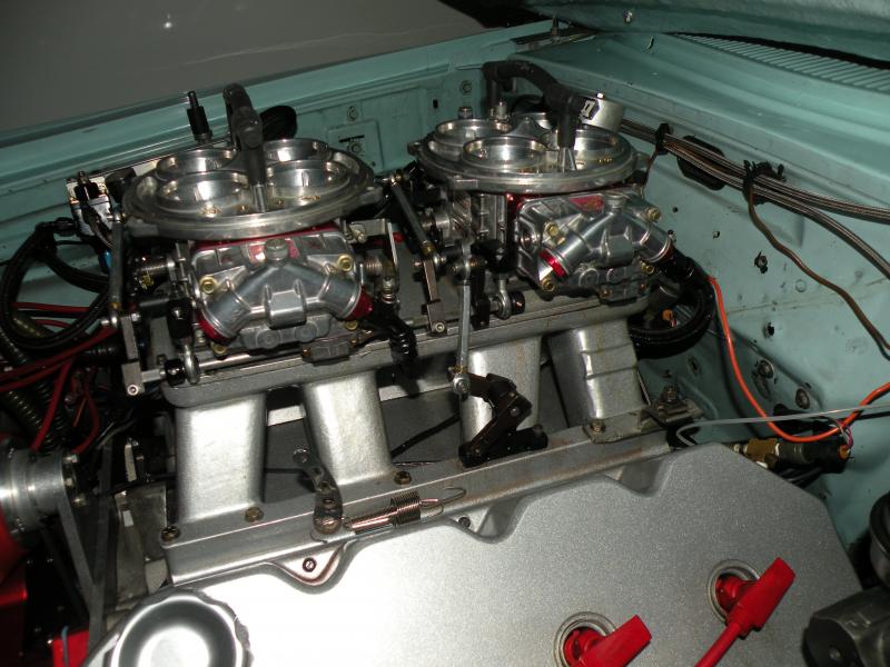

Go for it! Ran a Weiand TR with 2-750's on top of a 440 in a 68 road runner. Ran a best of 10.50 but wasn't consistent until high 10.60's. Would run a 10.68 on any given day and a .69 leaving at an idle. Loved it!
Good luck with the throttle cable with sideways carbs on a tunnelram. it's a real bitch.
Ask me how i know?

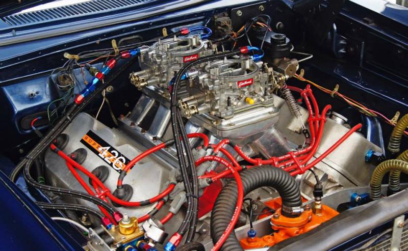

My Hemi and B1 wedge tunnelrams
Ask me how i know?
Yeah, I ran mine front to back....makes things much more simpler....I mean really much more simpler lol

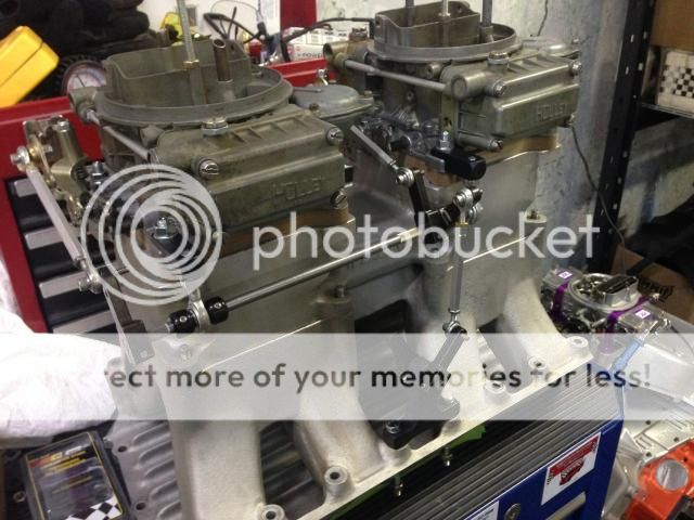

My hemi in the 65 Plymouth runs front to back. no problem at all. but when you go sideways,it's a totally different animal.
Nice piece. What is the CI?
505 4.4bore/4.150 stroke. just an iron headed street motor. gets driven a lot. although i would really like to invest in a "good" set of aluminum heads for it some day, when i built it 12 years ago i was a 25 year old kid on a extremely tight budget, only reason i was able to afford it is because i worked in an engine shop at the time so i did all my own machine work / assembly.

thanks for the pics, i was thinking i would have to make something similar to the bracket on the middle pic.

That looks like an old early 70's Pro Stock scoop on your dads Dart. Your setup looks nice. Kinda reminds me of the 70's Pro Stock tunnel Rams. Will that fit under your Hemi scoop ? Really looks good. Ron

should be better than the old Cross Ram for even distribution too
I ran that same style of scoop that's on your dads car,
back in 1979-81ish on a 68 Charger with a RB combo
with an old Weiand Tunnel Ram with dual Holley 660cfm's inline,
later with a Edelbrock TR & dual 770's sideways,
both Edelbrock & Weiand had/still has linkage for them
good luck

Enderle is the place to get the linkage. Great company and the best prices.
i'm not sure if it'll fit under the hemi scoop or not. i would have to cut the hood more, i just have 2 holes in it now for the cross ram. i'm pretty confident though there is no way it'll fit under the hemi scoop with air cleaners, which i plan on running. Good thing is its the same car thats in the vintage pic, so other than needing paint the old hood should go back on without two much issue.
yep already have the Enderle, i set it up the other night before i powercoated the intake.
Put the early prostock hood scoop on! Im a little partial to the early 70,s a body prostock look.
