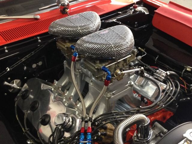

lets try a tunnel ram

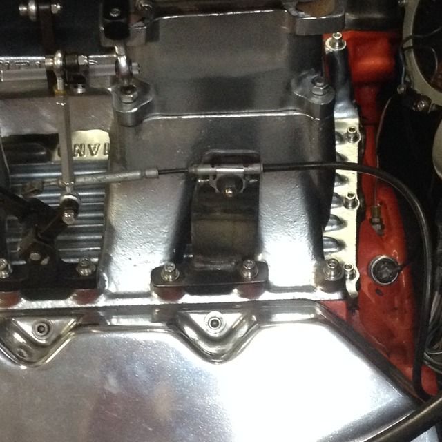

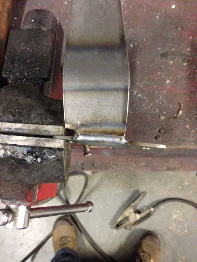

well its bolted on and ready to go. fabbed up a throttle cable and return spring braket out of some sheet steel. Just need to find some time to light it off and play around. these are not my air cleaners of choice but, for $20 bucks a piece they'll work until i figure out if i like the tunnel ram or not on the street.
Good to see you wearing your steel cap boots mate and it looks like you know how to weld !! Set up looks great, all the best with the combo.

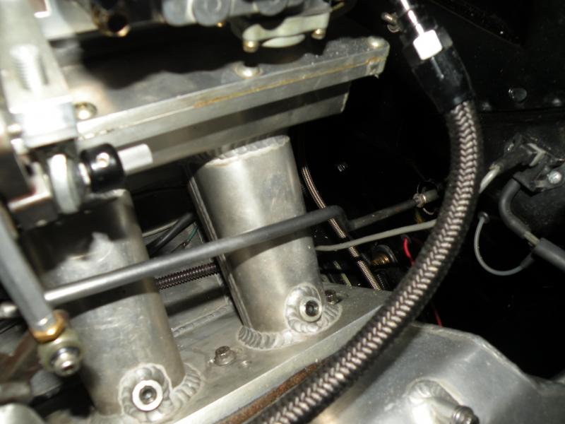

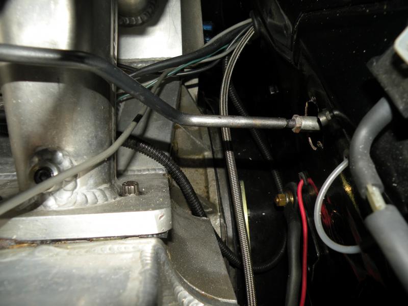

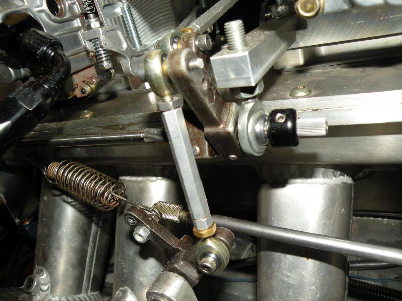

Hope the throttle cable setup works for you because that exact setup got me 1/2 throttle feeling good then it got harder and harder to push. I went with a solid rod instead and cured my problem
