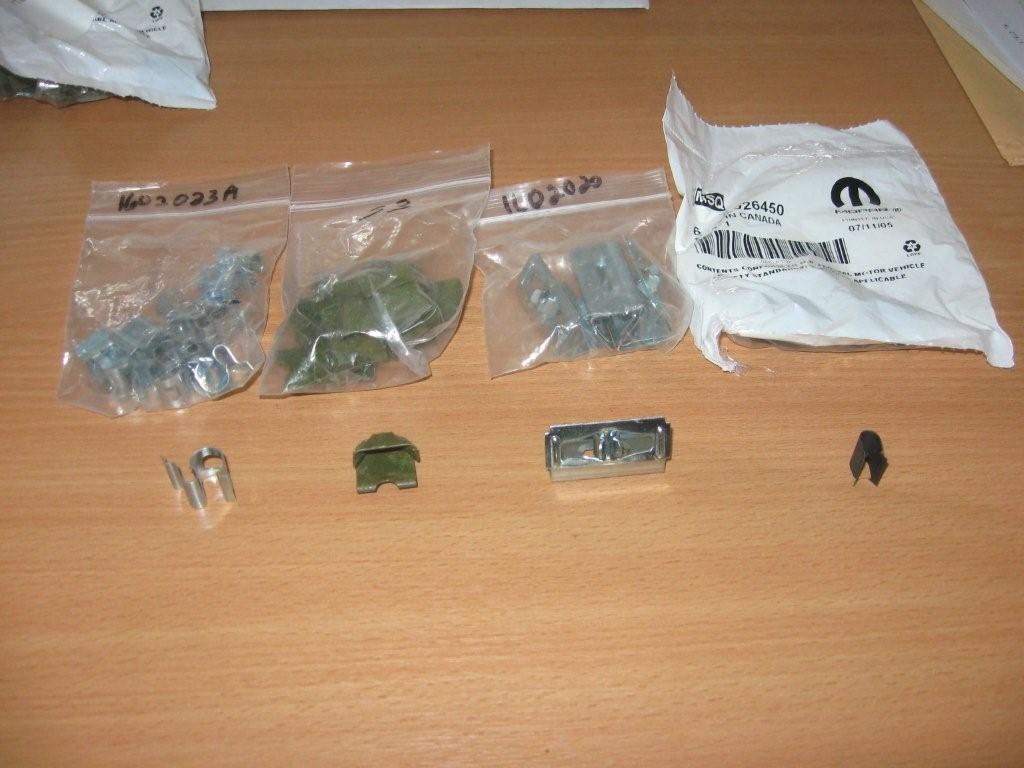

What about the clip at the right of my pic? I bought it but I don't
remember having any when I removed the old headliner.:confused:
on the far right? looks like the ones that go along the roof rail (top of the windows)
While you're trying to digest all this, also try to remember there are some clips on the painted molding that goes up there as well. Those clips can't interfere with the lil clips to hold the liner.

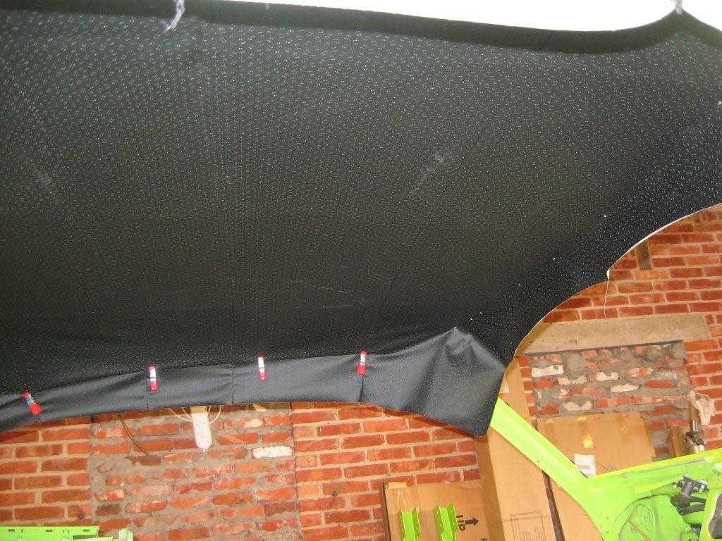

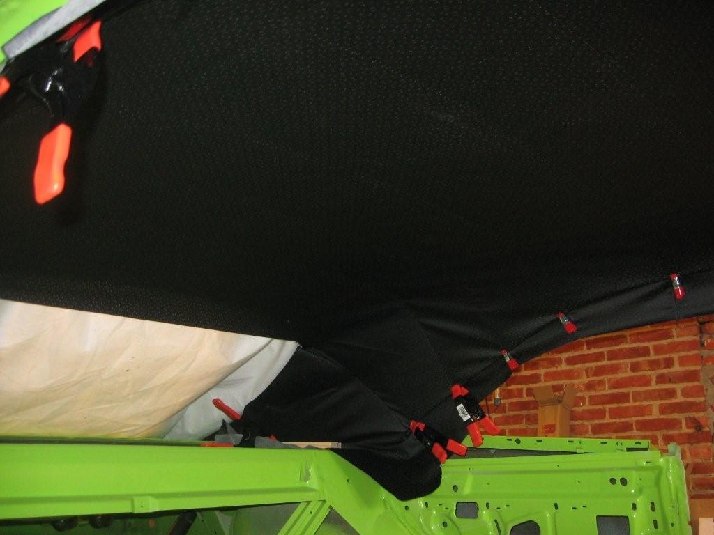

Thanks guys! Now it's hanging there by clamps, I rather soon discovered that cutting the sleeves enough is important to be able to stretch enough.
It's rather good from front to the half roof but the back isn't. When do I start
to cut in the headliner for the A-pillar and sailpanel? I'm afraid to cut too
much. Should I use a heatgun to make the material moore soft and get the wrinkles out?
