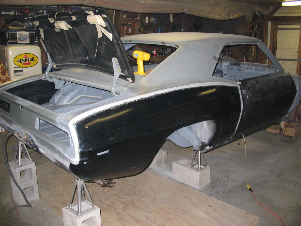

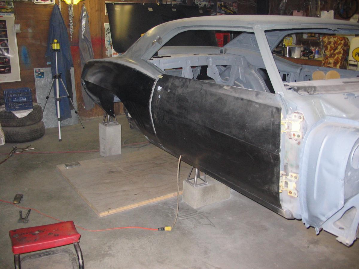

This is what I had to do on a project a few years ago. You can see the stands I used. They came from the local RV dealer and they did the trick. In the back ground you can see the rotary laser level. I don`t remeber how much it was but it was cheap and easy to use. Hope this helps give you some ideas! Goodluck!
Exactly how was the rotary laser level employed?What points on the car were aligned with the level?I have seen the rotary level used in an open room to set ceilings and floors,but I'm not sure how you used it.
Ron
You can set the laser level at whatever height you want so measure at the window channels, door sills, fender mounts, tail light openings and marker lights works. I also marked out the quarter panels every few inches to make sure everything was staying parallel.
You can also set the level up on the floor and measure off of the frame. That would make up for the uneven concrete. It works great once you get the hang of it. You`ll be measuring everything! lol
