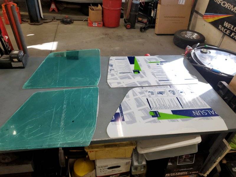

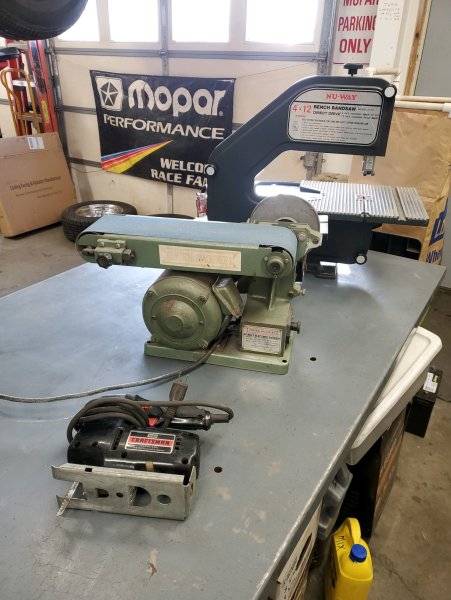

Our well equipped factory has nothing but the best equipment. 30 year old Craftman jig saw. Harbor Frieght belt sander and a borrowed band saw. Now producing lightweight Lexan windows. Available exclusively for 62 Plymouth 4 door. Guaranteed fit. Oh and if you don't have enough Lexan. Dad has extra in stock. 9.2 lbs total.

Just a side note, the early cars had flat glass, the 66 coronet is curved. Makes it more interesting..

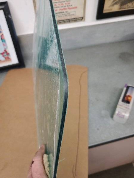

They could be hit with 240 grit. To be honest they look pretty much like stock glass. I've seen them hit with the torch. To me it's too shiny.View attachment 1433615
How are you finishing the edges?
I have a tip for you if this picture shows how you leave them.![]()
A friend of mine does acrylic fabrication over here.I've seen them hit with the torch. To me it's too shiny.
Just as a note, using 3/16 Lexan for the windshield will keep it sturdy under speed and pressure up top at the lights. It will still be lighter than the factory glass, but not as light as 1/8. Using 1/8 for this section may make it bow in or out depending on the vacuum, but some cars are well sealed and do not get affected such as DVW's masterpiece.Crap! I didn't think about that. Wonder if I can arc/bow a piece of sheet metal the same as the PS window and heat the lexan until its lays down. Guess I'll find out...
