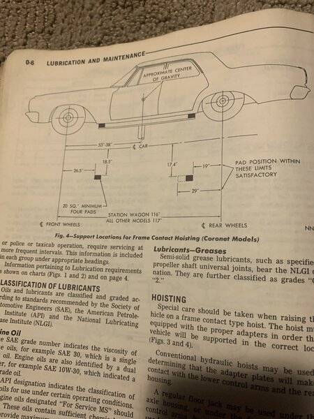

Just finishing up the installation of a Nussbaum two post lift after raising the roof of my shop 4 ft. That was a J.O.B. in itself. Any way sent away for a Chassis Lift Point Guide but it only covers the years 2000 to 2020. Works great for my 2017 Silverado 2500 HD but not so much for my MoPar. My Plymouth Satellite convertible is a 1966 model with a 383. Can anyone supply me with a lifting points diagram or direct me to one?
Your over thinking it, the car sits on it's tires it's whole life so lifting it at the subframes behind the front tires and in front of the rears will be fine. Mine isn't a convertible but I lift at the leaf spring front hanger and as far forward on the front rails as I can before it bends upwards.
Welcome,nice convertible! this Lifting Info is in the factory service manual. Section zero maintenance
