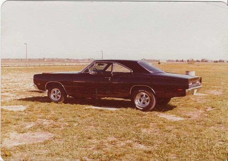

It all depends on what look you are going for. Here's the 70's look!
Didn't like that look and still don't. If anything, I'll lower the front end 1" and leave the back stock.....
That’s what I was going for, my back tires are too narrow because of a dumb eBay seller.
If I remember correctly, mine were 15x8 reverse with a L60-15 tire. That was a real popular size back then. Gabriel Hijackers to lift the rear and just crank the torsion bars up on the front.
Perfect. The guy on eBay had them listed as 15x8, but when I opened the box 15x7. $300 for all 4, he refunded $150, so whatever, they roll
