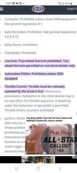

Thanks Rem, fair enough, it’s on the list for alteration during engine refresh, easy to do,Technically , they're not allowed to be on the rear in competition. But if tech never looks, and you have no enemies, you are free to do as you wish.
The reason for the rule is, if the rear locks up for any reason, you're toast.View attachment 1400997

Maybe cause NHRA doesn't permit four wheel line locks?Line lock- on rear brakes?
