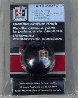

I really like their shift knobs with the button in the knob. I especially like the "sidewinder". The button position is off to the left and comfortably under your thumb. I've never had a button fail but the buttons are inexpensive and replacement buttons can be found at Radio Shack. The reason I know that is because I made one for another car using a regular round knob.
