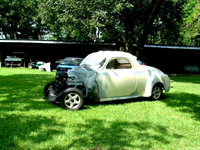

So I tried joining the Chevelle forums to ask about late 60s Chevelle's, since the 41 Chrysler is sitting on a 68 Chevelle frame.

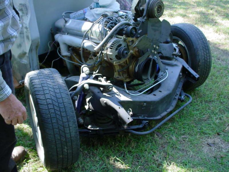

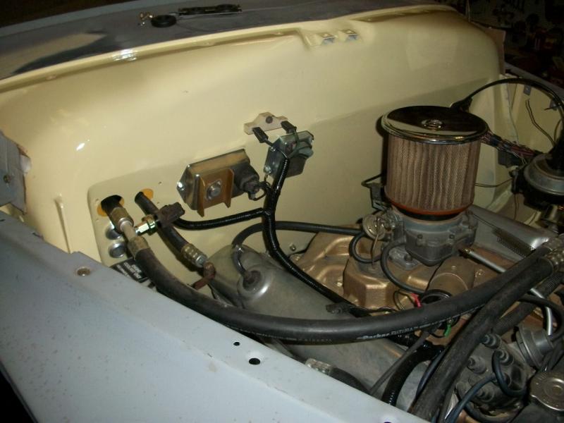

Sad but true...some are very very restrictive on who what when and where....I have no clue as to why the 41 was set on a Chevelle frame given the original chassis configuration is what is copied still today..mine is still 41 chassis, R&P, Disc brakes, relocated shocks beefed sway bar..383/727 with 2.72 ratio 8 3/4 (cruiser gear)

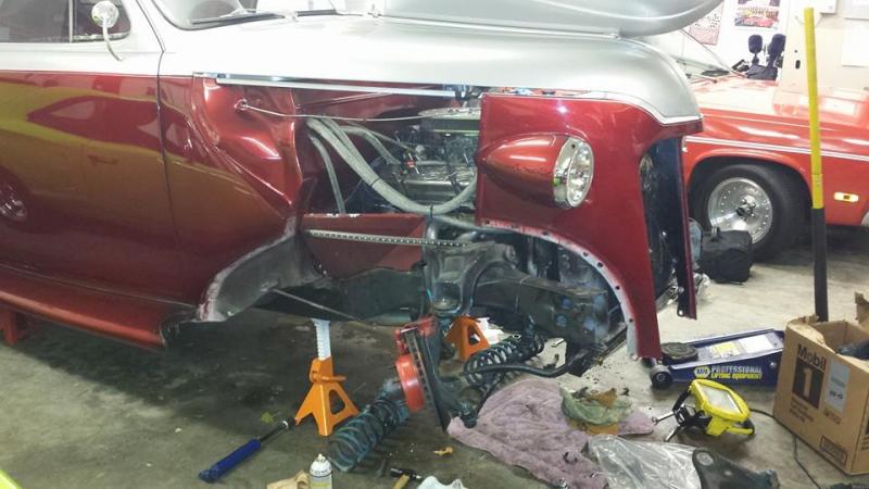

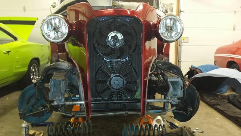

Yeah who needs those freaks, bigaadams, cool car, got anymore pics of it?
My Wifes pride and joy
1378249_10200764580100128_503787556_n.jpg1400819_10200751467972333_317111810_o.jpg1484319_10202283787788585_1727620536_n.jpg1535016_10202283786588555_734184764_n.jpg
thanks...it is just sitting in the garage awaiting me to get off my can and finish the paint job..then put together...I see mums if outfitted right....

That frame looks a lot different than the frame under my 72 GTO. Has the a-frame (cross member) been modified? I know the 68-72 chevelle cross member is not that thick. I don't understand any forum turning away a person wanting to join.

I think I have figured everything out now, but I was looking for center link, idler arm and ball joints. Was told it was Nova/Camaro, from the dude that built it 30 yrs ago, but nothing looked the same.
A NAPA guy and I spent 2 hrs searching his catalogs for the right stuff, I went and got the control arm, and it and everything on the steering linkage is blue, which he thought was a dead giveaway for Pontiac. but didn't find the right stuff.
So I went home and just happened to google Pontiac control arm or something and got a link to OPD, and the correct control arms. Turns out it is 68 or so Chevelle/GTO/Cutlass.
Searched Moog for center link and other items and they are the same too, YAY
