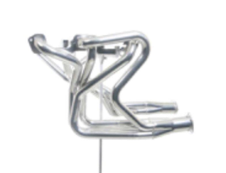

Your car may just not be programmed in to the database as being a "fit". I believe any B-body small block headers will fit.
Having said that, I will state what I have said before on some other threads. Many small block B-body headers route three driver side tubes under the steering. This makes the headers hang down really low and virtually guarantees that you will smash them into oblivion. (Ask me how I know :rolleyes: )
All the "offending" headers look very similar. Look at the headers below. The driver side has three tubes that go straight down, and then make a 90* turn towards the back. Lots of manufacturers have them, so I won't give you the name of these - it doesn't matter and I am not trying to bash (pun intended) any particular manufacturer.
Bottom line is stay away from any headers that look like this if you need ground clearance to drive your car on regular roads.

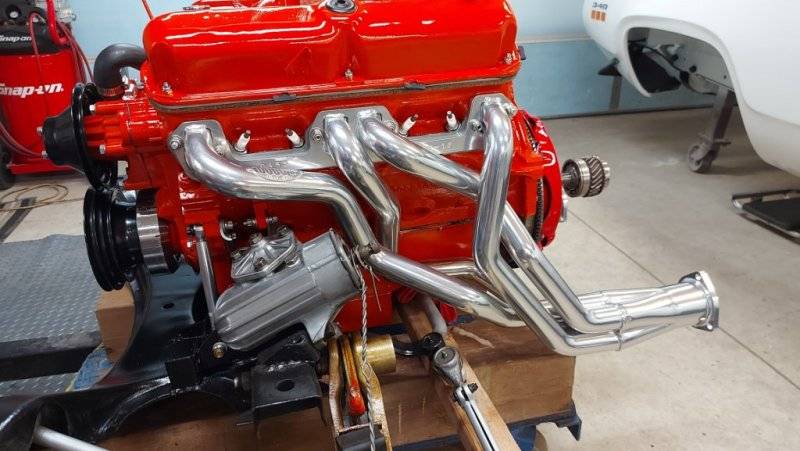

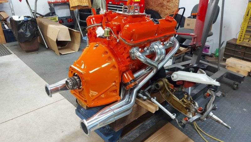

TTI should have all you need as I did a 79 Cordoba B body with a LA small block.
Their headers do not go under the drag link. Not cheap by no means. But very good quality.

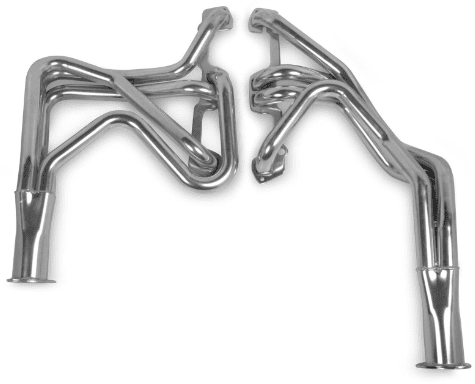

Tim,
These are Doug's headers.
They should fit nicely in your body style.
My buddy has the same set in a small block powered F-body Aspen.

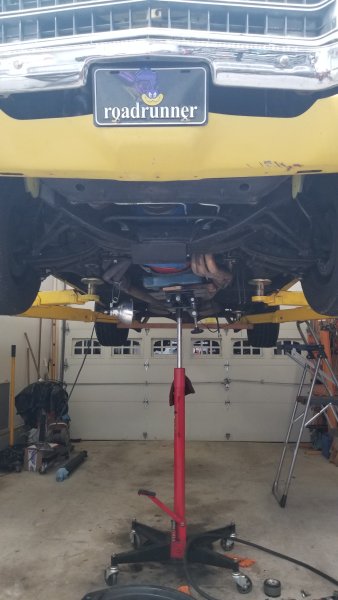

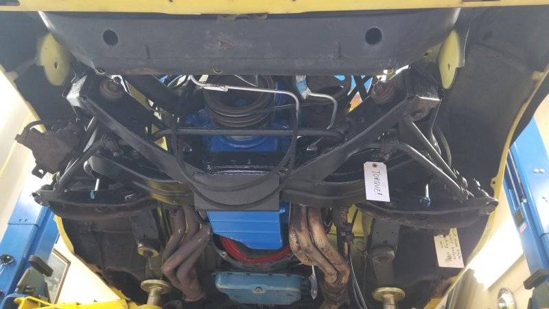

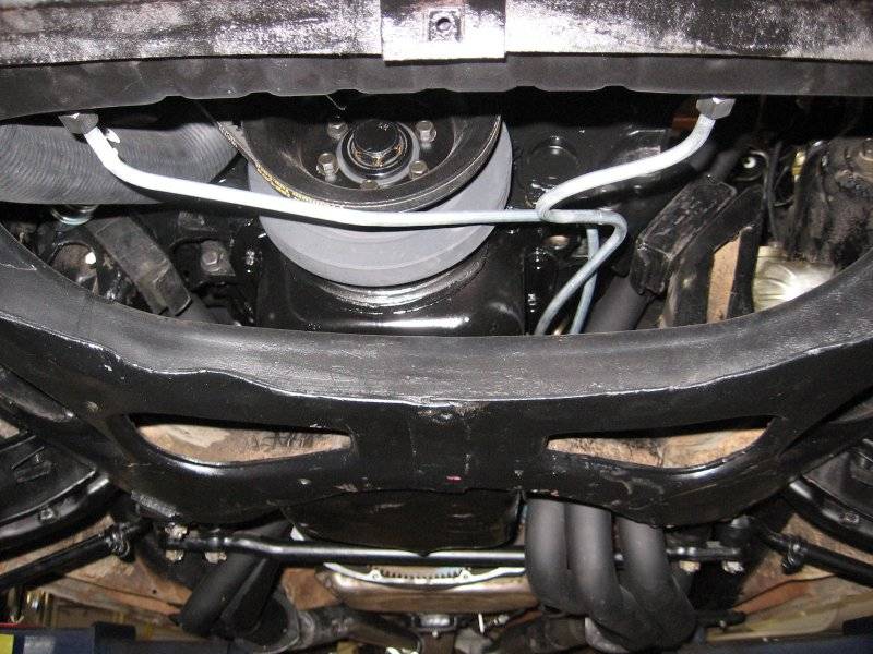

I have now sold my 73 Road Runner that had those headers, so I can no longer give you a measurement. Below are the best two pictures I could find.
Note that I had a big piece of angle iron welded to my K member to protect my oil pan and headers. Even with that, they will still hit a bit.
My best guess is that they hang down about 3 inches below the K member.

Of the 3 headers I know that will fit, I can tell you that the cheap headers with 3 pipes under the steering linkage suck…. But Summit Racing headers have always fit the best AND they have a thick 3/8 header flange.
Then there are the more expensive:
Hooker Super Comp headers w/a 1-3/4 pipe and TTI.
TTI has a 3/8 flange, not the Hooker.
I have the Hookers on my small block ‘79 Magnum. Excellent fit!
I have only used TTI on my wife ‘67 Barracuda. Excellent fit.
I also used there exhaust system. Excellent.

This is true. But if you went to Summit Racings site and looked up a B or E body header you would find a bad picture but missed the 360* view…. Snap shots below showing you EXACTLY what it is.
No freaking homework done. Come on man!!!!!
That looks like the "standard", poorly designed SB Mopar header that there are two dozen copies of and drags the ground.
