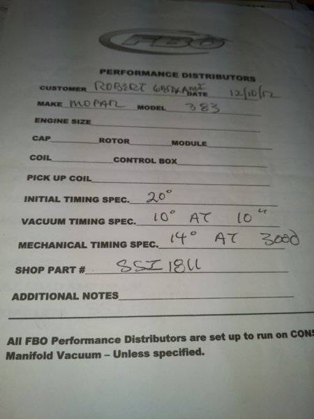

I'm assuming you sent it to FBO - did he tell you how he set it up?
That secondary spring can make a huge difference.
Yes FBO set it up. I would have to look at the spec sheet.
I would advance the cam 4* or more if it was installed straight up dot to dot. Good luck with ur mods. A good valve job can do wonders on a set of heads also. Kim
Look and tell us how it is set up. Often times running manifold vacuum at idle means intial timing (base mechanical without vacuum advance) is low. Instead of 20 degrees initial you might have 10 + 10 degrees of vacuum advance. Idle is good, because there is 20 degrees, but when you stomp on the gas guess what? You've got 10 degrees and your engine probably wants more. Many people disagree with Don's approach on this. That setup should have a minimum of 15 degrees at idle, and would probably like closer to 20-24.
Honestly I think you need to tune what you have first. A light secondary spring and a properly set up distributor can make a car feel night and day different. You might shave your heads and change intake manifolds and it won't make any difference if your secondaries are only opening half way. Then someone will tell you your carb is mismatched, you'll put on a DP and it will seem like that did it, when it was a $10 spring kit holding you back all along.
I'm all for the intake swap, that will net you gains. CR increase will too. But until you get that carb set up right and make sure your ignition curve is right its probably not going to help, or won't help as much as it would seem. That stock secondary spring is heavy, your secondaries are likely not fully opening at all. Tuning what you have will take less time and cost less money than taking the heads off, and if it doesn't get you where you want to be you'll have just gained valuable experience and can start changing the big items.
so this is the set up. Way better than before I had sent it out. I think it is just like you recommend. I will check on the secondary springs when it is back together. Is there a way to know if they are opening all the way being vacuum controlled?
View attachment 895940 so this is the set up. Way better than before I had sent it out. I think it is just like you recommend. I will check on the secondary springs when it is back together. Is there a way to know if they are opening all the way being vacuum controlled?
That looks like exactly where I would start - I would just say be sure that you've got 20 degrees at idle with the vacuum advance disconnected. You can experiment with a bit more timing, up to 24 initial and 38 total are not out of the ball park. But that setup is a good base.
You can check how much secondary action you are getting by putting a paper clip on secondary actuation rod (on the right side of the carb, under the vacuum diaphragm). Put the paper clip right up against the vacuum pod, and it will slide down when the secondaries open and give you an idea of how far they are opening. How quickly they open is also important though, so it is good to try a lighter spring even if you find they are opening all the way. Usually Holleys come out of the box with the heaviest spring (black). The heavier the spring the less they will open, but it also delays the opening point as well.
