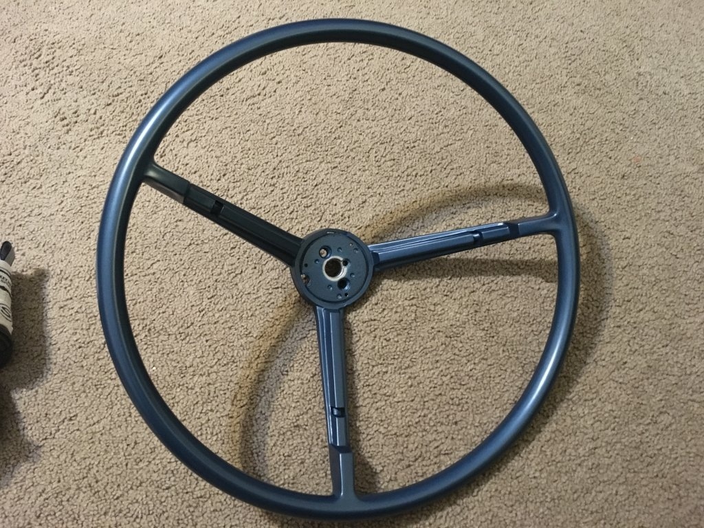

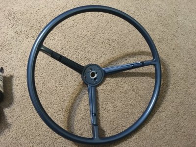

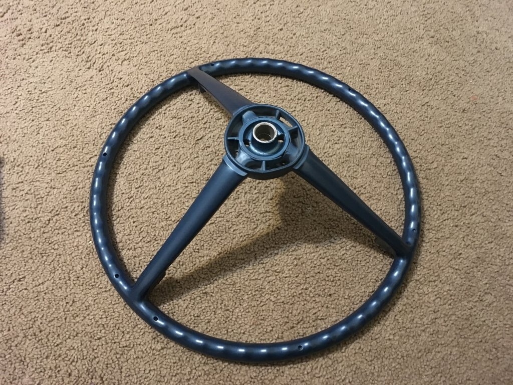

baltic blue is the color name I got mine from Kolor korrect. Someone painted the interior black
but there was original color left on the dash in some hidden spots and in the door glass opening. The dash,steering column and upper windshield trim have the suede finish.
The looked dang close to me. Here's a pic of my wheel I just finished up

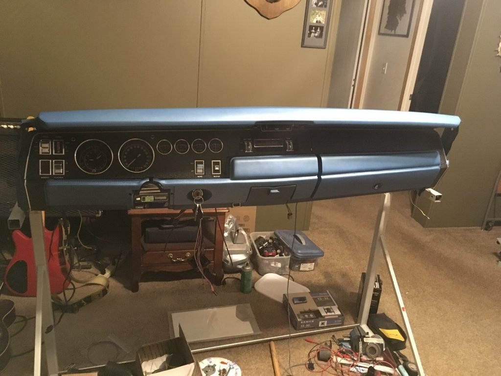

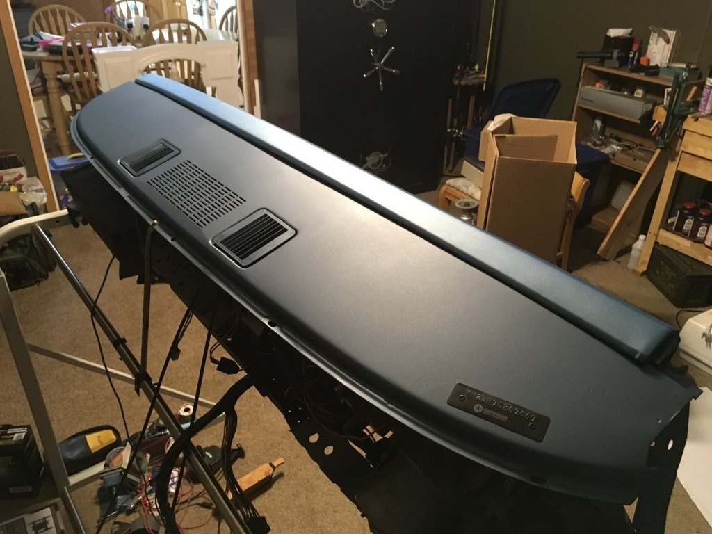

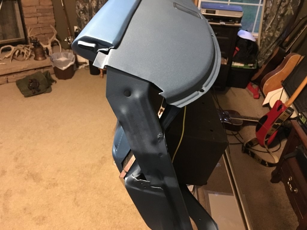

Here's some pics of the dash. I think my pads are to light but they were done with OER bright blue. I plan to repaint the pads with 330 dark metallic blue

Classic industries has it. OER #1177 PP330 dark metallic blue in spray can the color on the pads currently is PP338 bright blue. Check out the classic industries website. The color on the dash frame is Baltic blue suede from Kolor korrect it comes in a pint to mix 1 to 1 with lacquer thinner
and applied with a gun.
