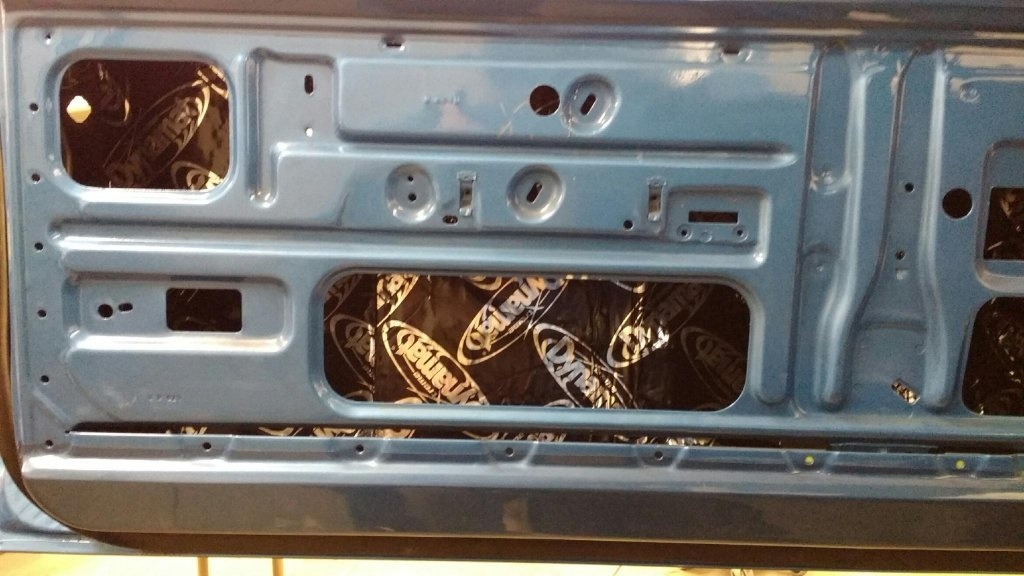

Got some answers on the correct blue for 69'. The classic industries bright blue pp338 is correct for 68' charger upper door pads. The Baltic blue used from Kolor Korrect is correct for 68' dash. I can say at this point don't rely on Kolor korrect should be called "kolor kinda korrect". I would for sure recommend contacting Dave at performance car graphics to get the correct colors.

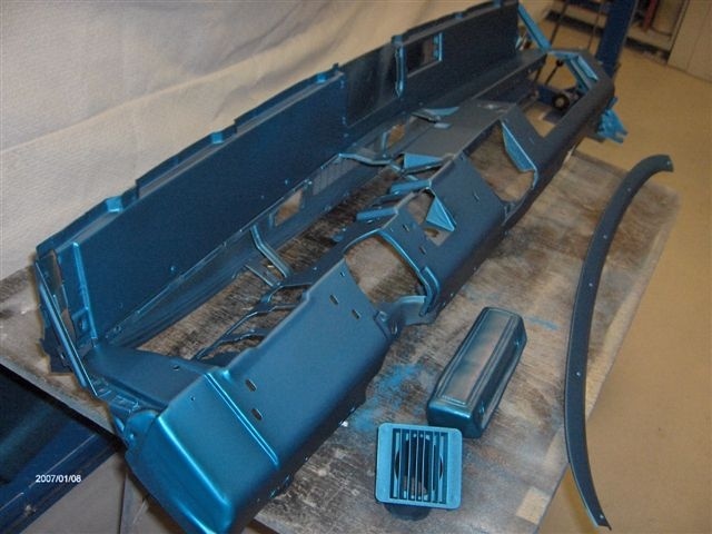

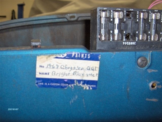

When I restored the 68 Hemi GTX on the bottom of the dash was a paint decal from the factory. I took a picture of it. Hope this helps.
That's the blue right there. The Kolor korrect is a shade darker.
I have to ask what is the QQ1 code and where did you find it Malex.
BeeKeeper thanks for the info! Is your interior 2 tone? Judging from the picture I would guess my dash to be darker. I may give Dave a call today.

69 GTX, yes a 2-tone. Lighter blue along the doors. The picture I posted a few comments above is the factory paint code decal and where it was located. Right next to the fuse box along the bottom edge. I made sure to grab a picture of it.

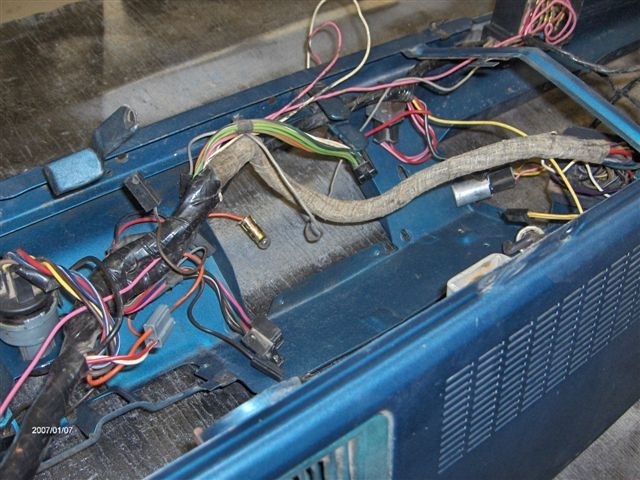

I dug out a couple more old pictures from that dash. Wow, 10 years ago already..
That looks about right! Thanks for the help. Are you leaving it that color or repainting it.

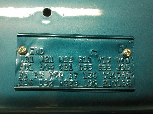

Beekeeper so here's my fender tag, what code am I looking for?
Looking at your fender tag
Your car is B5 B5 P6D B7
First B5 is exterior
Next is roof color
P6D B7 is interior color

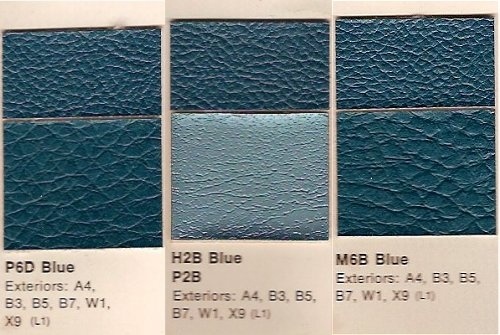

Here is a pic of color samples of each interior code in blue
RS23:
Plymouth Belvedere,Satellite
Special, GTX
2 Door Hardtop
L9G: 440 375HP 1-4BBL 8 CYL
1969
St. Louis, MO, USA
: Sequence number
E86: 440 cid 4 barrel V8 (High Performance) 375hp
D32: Heavy Duty Automatic Transmission
B5: Bright Blue Metallic Exterior Color
B5: Roof
P6D Trim - Basic, Cloth/Vinyl Bucket Seats, Unknown Color
B7: Unknown Int. Door Frames
128: Build Date: 28th JAN
: Order number
A01: Unknown Top Color
A04: Basic (Radio) Group
C21: Center Front Seat Cushion
C55: Bucket Seats
G33: LH Remote Racing Mirror
J25: 3 Speed Wipers
L31: Hood/Fender Mounted Turn Signals
M21: Roof drip rail moldings
M33: Body Side Moldings
R11: Radio Solid State AM (2 Watts)
V1X: Unknown
V6W: Longitudinal Stripes, White
END: End of Sales Codes
I appreciate the info guys, you've been a big help!
