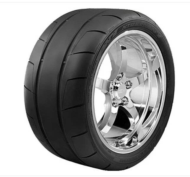

For traction, I run Nitto NT05-R drag radials on the street. They bite even in first gear.
That's great. They look "sticky".

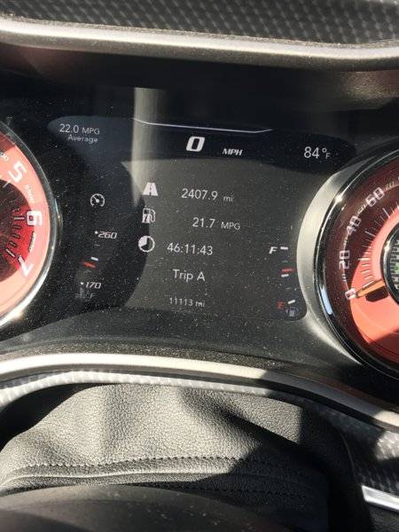

I was just out there with the Hellcat but a little better mileage, lol.
