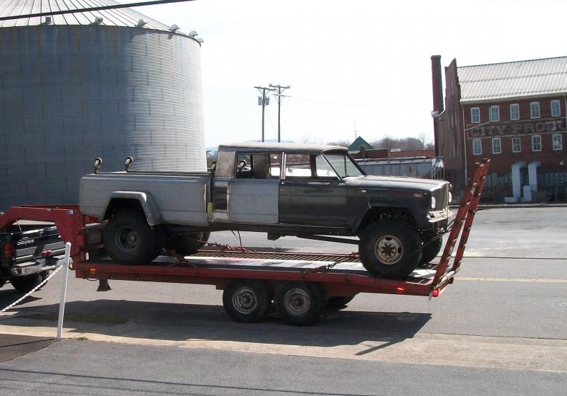

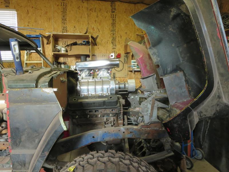

I think I should explain what I am after and doing. I know this is a mopar car b body sight but I'm am here because of wanting to find out some sudjestions for the 440. I'm am putting up a couple of picture of the motor mockup and truck this is in. the engine block in the picture is not the one I'm am biulding as my engine biulder found a small spot on one cylinder and boered it out to 60 over to see if he could clean it up, sudjested I sleave it,,so we are useing a different block. this is going to be a sorts of daily driver /tow/ show truck. I'm looking for a good all around driver with the cool factor on the engine,,nothing to out raigest. 048.jpg171.jpg
