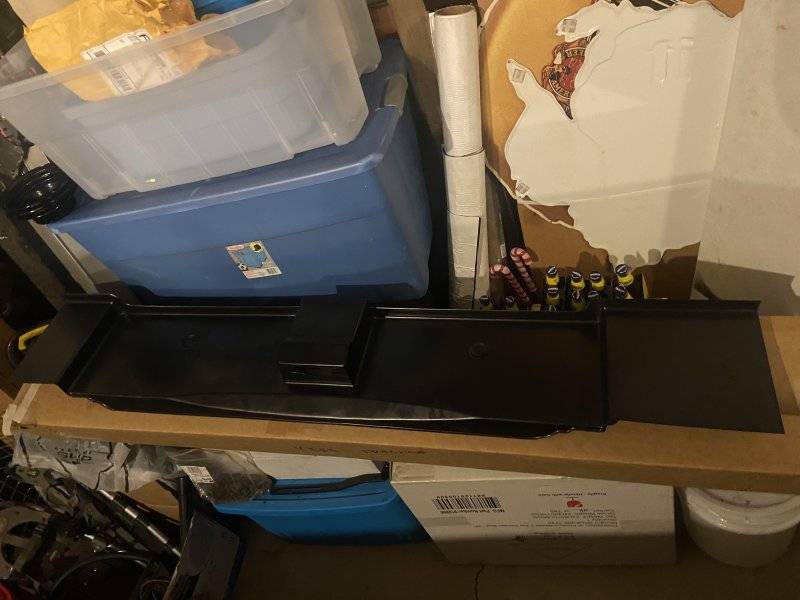

HI, Since I cannot find a decent used inner trunk cover for my tail lights and it appears there is no repops to be had, I am thinking of reproducing these myself. But what I need is a few nice clear photos of what they look like. If anybody on here has a correct one installed in their 66, I would be real appreciative of getting a few nice pictures of one, as I do have the means and equipment to possibly do a small run of these.

I can get you pictures and measurements. How soon do you need?

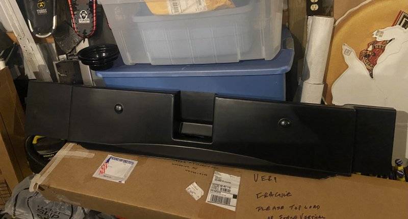

Have this picture from a member here:
It took a while for me to get mine. Not sure why I hope all is well with him. I do wanna say the piece I received is excellent!!

I will try and use these pictures and start with a cardboard mockup. I will post my efforts and see if we can come close. It appears he had an original to just add some mold release agent and lay a piece of thin material which was first heated and then put into a vacuum forming press. I am thinking on doing them in fiberglass or maybe a vacuum formed mold.
