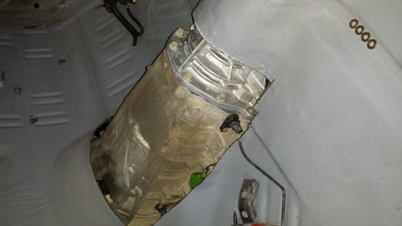

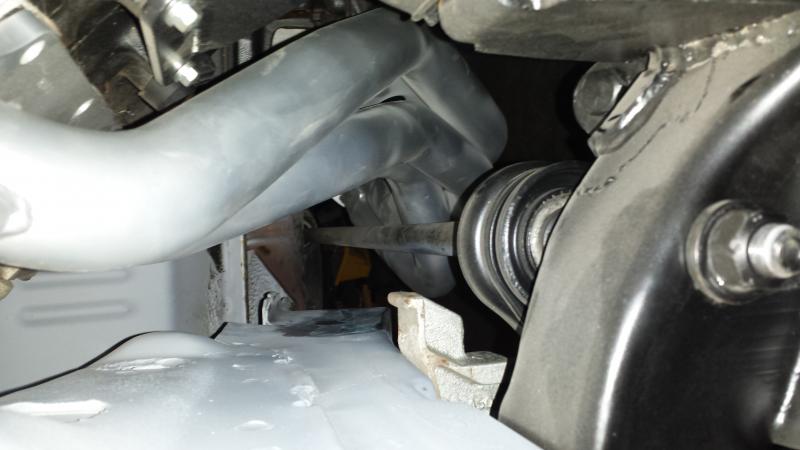

I just went out and looked at mine and a passenger side starter will not fit with those headers. I don't have a console but the tunnel gets pretty wide and looks like it will be a couple inches taller once its welded back in.
Thanks much 69_ply. Good to know before hand. Do you have any pictures of the tunnel fab and or the right side frame rail area where the Header drops down. I assume you are using the 545RFE trans.

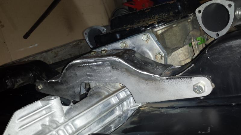

not sure why the pictures did that, might have to roll the monitor around!
Thanks for the pictures! It sure looks like the right side starter will certainly create a problem with any kind of exhaust. What are you using for a shifter? It looks like the crossmember lines up in the right place. Just needs to drop down a few inches. Is the tail housing the stock housing from a truck 545RFE?
No shifter yet (can't make a decision), the cross member took a lot of work to fit and look fairly stock, the tail housing is a factory 2wd truck piece my trans was 4wd.
