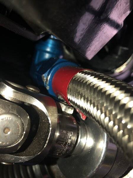

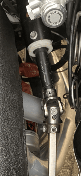

1. Steering shaft and joint s all be good , just the missing O-Ring between the column bracket and retainer on the firewall , ( the 4 clips around the outer column Shaft I already order it and get from” Member moparmaniac “ but get only 3 until now inside because my inside shaft In the column are not 100% center / or the outer little bend . I will fix this too .
Also I will bring in a completely new rack and pinion flaming river FR502 , because the “ old one “ just 4000 miles on it but have a little play in the housing to the inner tie rod on passenger side .
after I get the clip number 4 / the missing O -Ring and the whole New rack and pinion in it I will see something change to good or still no change on the vibrating .

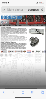

Next Idee is to install This Borgeson vibrating reducer joint , and take the normal universal joint without vibrating reducer out .
But for this Exchange I looking for a way to modified my original column steering shaft , because Borgeson sell this “ vibrating reducer joint’s” only with shaft end ‘s like double D ( D-D shaft’s and / or many different sizes but With splines / or pyramid style etc ., but they not seel it for smooth round shaft ‘s without splines , because they fear the people weld it on and meld the vibrating compound in the joint .
But my 68 charger column Are smooth round without splines and already cut it and pinned for the normal flaming river joint coupler .
