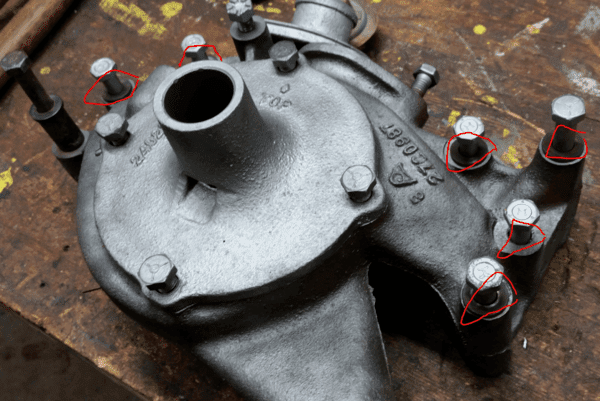

so working on my semi-**** 68 X restoration project.
working the front engine accessory package currently and trying to figure out the housing bolts. I'm well equipped with OE bolts and what not but trying to understand better washers under the housing bolt heads. what did ma MOPAR do here? See attached pix and red circle ish things.
did they all have washers? Did none of them? Or some of them?
thanks for input!
The 4 "H" head bolts that mount the pump housing to block do NOT use washers. The alternator bolts are correct. The power steering bolts. You have one correct top bolt with washer but the lower bolt with the "H" is correct for a manual steering car. Your missing bolt (the adjuster bolt) has the same head and washer as the top one. I am not sure of the length but I think they are the same.
