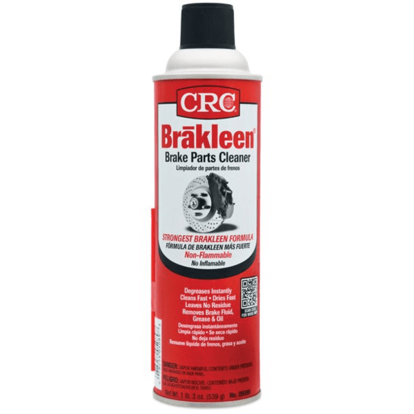

I'm almost certain it's what was used in dealership shops back in the 70s. BTW, the CDC describes it's primarily used to degrease metal parts.Triclor would evaporate in a few weeks, great cleaner but not for a parts washer.
It's also the main ingredient in this, which is why it does such a good job.I'm almost certain it's what was used in dealership shops back in the 70s. BTW, the CDC describes it's primarily used to degrease metal parts.
It is used mainly as a solvent to remove grease from metal parts, but it is also an ingredient in adhesives, paint removers, typewriter correction fluids, and spot removers.
