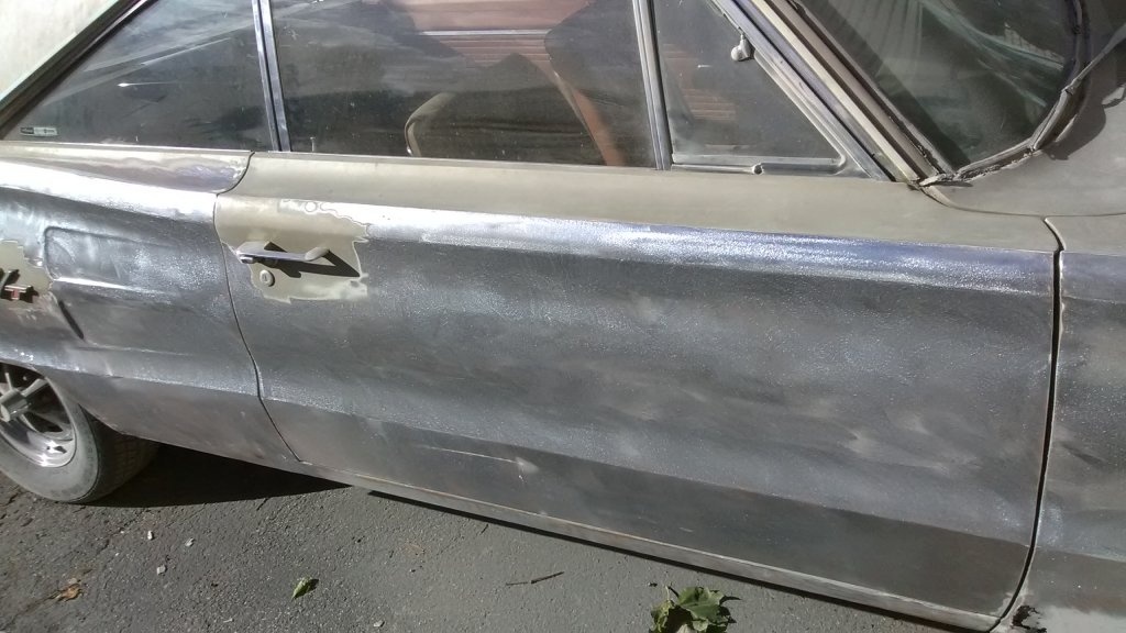

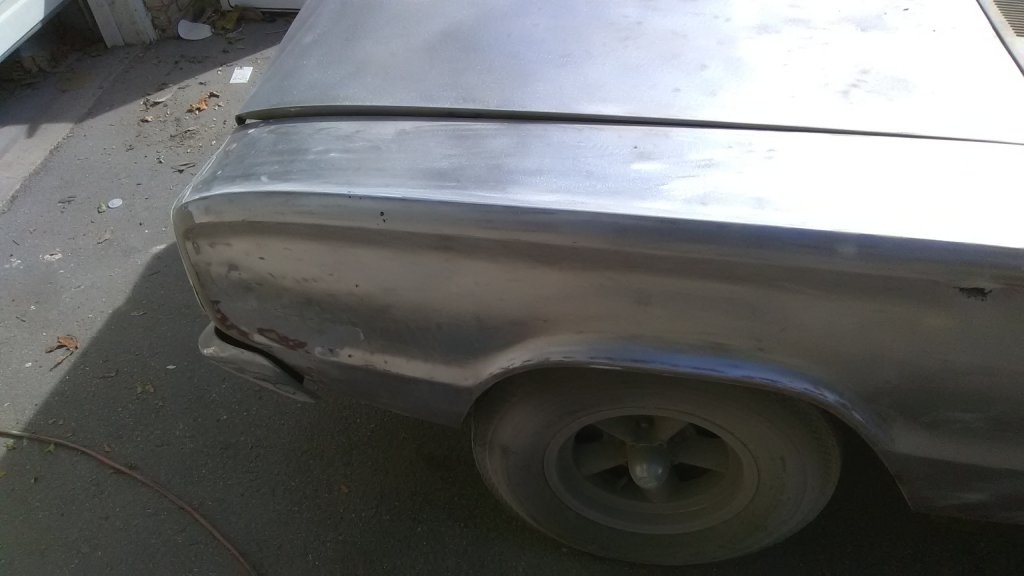

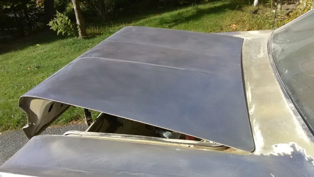

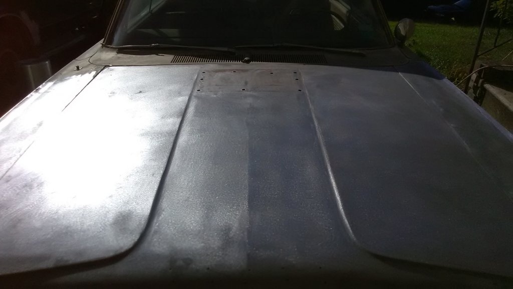

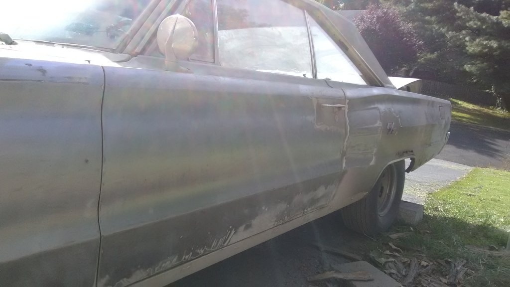

been working on my 67 coronet its about 75 % stripped down had issues trying to get pics from my phone heck stripping the car was easier lol, Im very pleased with all I found or better yet didnt find so far the prev owner was 100% honest about the car
What are you using to strip the paint?
I use the 3m stripping and cleaning pads then Ive gone over with my da with 40 grit then ill go over with 80 to prep metal for primer
Wow looks solid. 67 R/T is my favorite. Maroon/red interior? Cool Mopar.

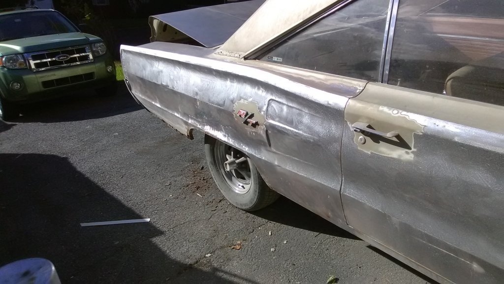

yea shes real solid one owner, runs and drives not 100 % but strong, the other side is stripped and about the same rust no its a white car with copper dust metalic interior Ive never seen that color combo but I think it will look very nice when done
im having a issue tho I tried to buy this for 3 yrs and finally got it but now may have to sell due to trying to but a super bird

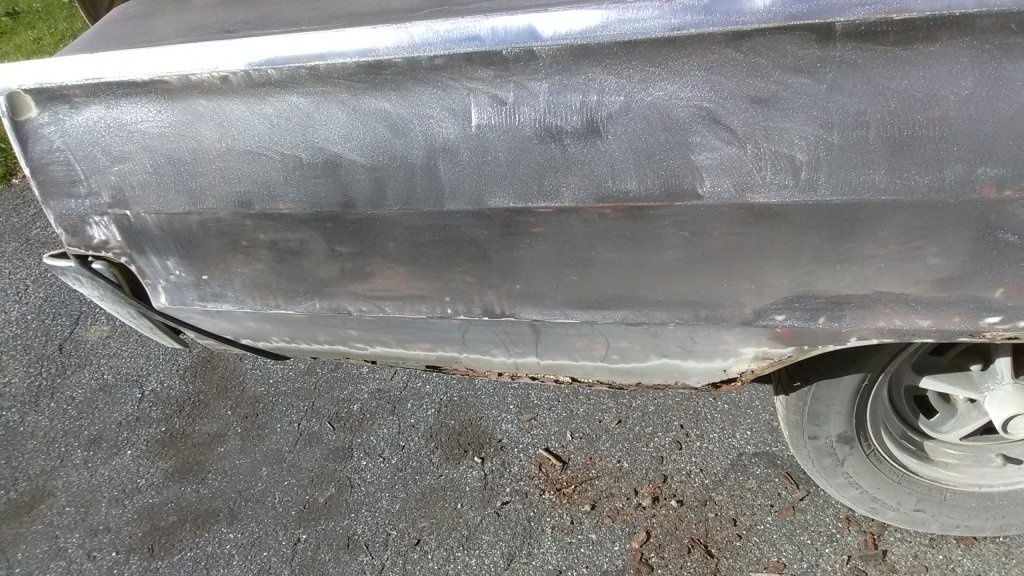

Are you going to seal it before priming? How long are you going to leave it exposed before shooting it? Just curious to what everyone is using when leaving the metal exposed for an extended amount of time before shooting....
You gotta media blast that car...I gotta respect your efforts in that labor you're expending.
IM shooting it very soon with epoxy primer its in a heated dry garage so not very worried about the exposed metal it only took about 15 hrs so far and due to wiping the exposed panels down with a metal prep that keeps it from flash rusting till I do shoot it

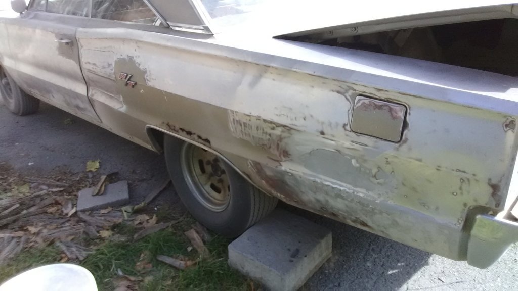

got most of the drivers side today got the dam flu so I didnt work and their is no way I can ride the sofa 2 days in a row I did find two areas with some bondo in them one in rear quarter and another in front fender the old timer I got it from did say he had a fender bender back in early 70S the metal is still sound under it tho
