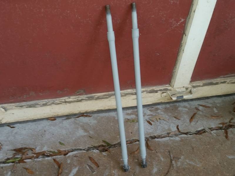

tbrow the extra couple bucks in and go with qa1 dynamic rods they're a very nice piece and about 1/3 the weight of the MancinisFound the Mancini ones, they are 1 inch dia.
You fellas are awesome! Thanks a bunch. I have extreme chassis black to spray them with. I'll pm you both with the address.
Thanks but i'll spray them so they match everything else.I was going to shoot them with VHT High Heat ceramic black and cook then in the oven . . . but it's not a glossy finish, it's more matte - but it's ceramic . . .

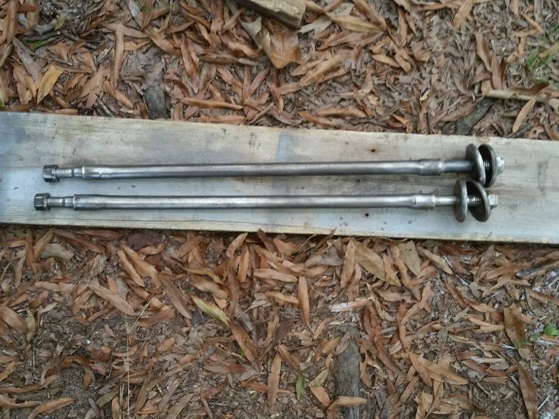

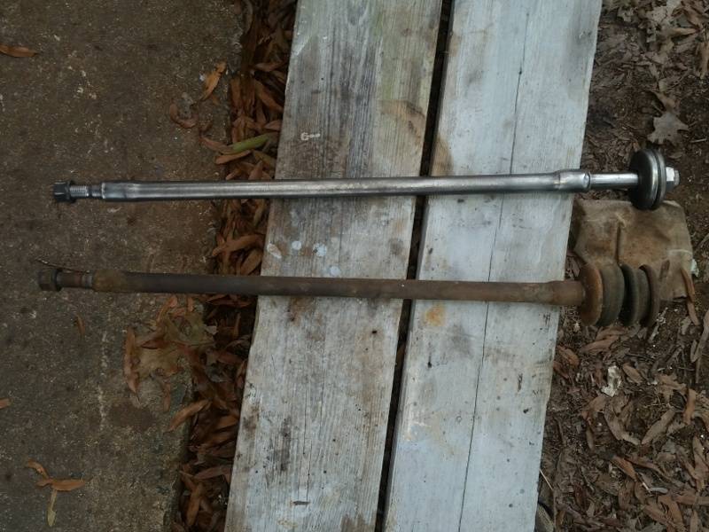

Thanks pal, they look great! I have all of the metal cups and they are in great shape. I do need all of the nuts though so please include them. Thanks again! Randy.Roger that Ghost . . . Here's the scoop . . . they clean up pretty nicely . . . ( here's the comparison )
QUESTION - Ghost - do you need for me to send up the metal cups too ? Or do you still have them and are they in good shape ?
Do you want / need the nuts on either or both sides ?
Let me know what parts you need so I can get them up there to you . . . Thanks.

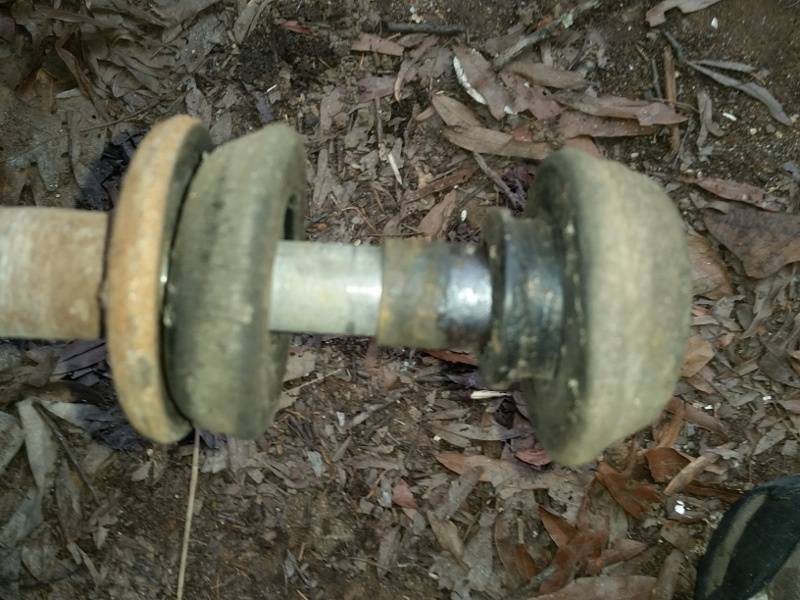

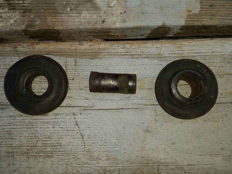

Just to note - ( it may not matter ) - the bushing with the metal sleeve goes in last - it's on the nut side ( I put them back on as I pulled them off to remember )
I think these are toast - Mike's checking his to see if they "should" be only (2) parts - not 3 parts ( if so, I'll pitch these in the trash )
Both of the cleaned up . . . looking good
Shot a light coat of primer on them to protect them - you can shoot them with your chassis black.

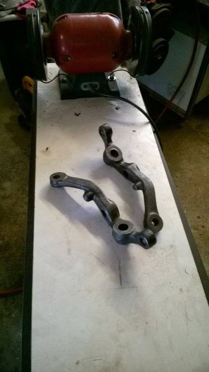

Am I missing something? Those knuckles don't even look like the ones that came off of my 66. The hole for the ball joint is much larger IF it will even come out plus the pin for the stop is right next to where the ball joint is located. Did your knuckles come off of a newer car?I have the old ones with 69,000 miles on them but I don't have anything to compare them to. We shall see. I just returned from my buddy's garage up the road where I used his big vise and impact air ratchet to remove the lower ball joint knuckles. Those things did NOT want to come loose!
OKAY!!!...I finally got my brain to put 2 and 2 together and get 4. The 67 Coronet lower ball joint arms are the same bolt size and bolt spacing as the 76 Plymouth Volare/ Aspen arms but are shaped differently. SOOOO...I need to get two 67 Coronet lowers and bolt them to the 76 knuckles so they will mate to my 67 LCA's. Wheewwww!!!!! Brain cells are overheated....and i'm a little slow.Am I missing something? Those knuckles don't even look like the ones that came off of my 66. The hole for the ball joint is much larger IF it will even come out plus the pin for the stop is right next to where the ball joint is located. Did your knuckles come off of a newer car?
