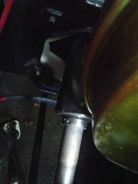

Like this ?
I have a Delrin bushing made up to put in the lower of my 65. It will hide behind the rubber seal that goes there. Much better job of supporting the shaft than the seal.
I bought one of the repops for my last project and ended up returning it. It was nowhere near the quality of my original. I ended up cleaning and regreasing my old one. Was debating getting a ER16 to try, but turned out there was nothing wrong with mine. Only issue with that other bearing is how it mounts. Originals have the raised portion of nylon to locate it and then the set screw through the outer tube. ER16 you have to turn a set screw onto the inner shaft.
That looks like the ER-16 bearing , did it install ok? and how is it working?
I had the whole column out, and changed it from column shift auto to console shift auto. So i put it in then. Easy to install, but i haven't had it on the road yet.
