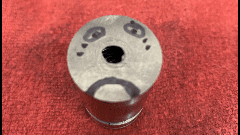

Well it finally happened to me. I have been breaking in cams in for years without issue. 15 minutes into break-in engine started hammering. Pulled intake and found this on #5 exhaust. It went down fast, sent shavings throughout the engine. I used Driven break-in oil and assembly grease. Engine fired pretty quick and I went straight to 2200rpm.
440 .060
Icon pistons
RPM heads
Lunati Voodoo 704 cam
Lunati Micro-tol lifters
Last winter I decided to refresh my 440 with a better cam setup. I called Scott at Competition Components whom I have done business with in the past and told him I would like to go with a little bigger cam than what he sold me before. Scott highly recommended going with a hydraulic roller cam because of all the issues with lifters and cams going bad during break in. Scott told me with the Roller cam there's no break-in period and no need for special break-in oil. So I purchased a roller cam from him and it's the best thing I could have done, yes they are a little more expensive but oh man did it ever wake my RT up

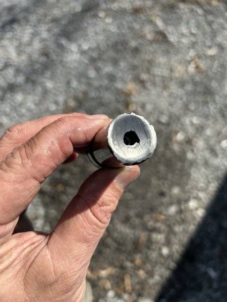

Here’s one from last summer.
Melling cam(same grind as the smaller summit cam, .442/.465 lift), genuine Hylift Johnson lifters(shipped direct from them), Stealth heads, stock rockers.
Broken in with Driven oil, on the dyno.
Lasted thru one summer.
Only this one lifter has an issue. The other 15 are all fine.
I didn’t take the pic....... I’m not responsible for the “art work”.

WOW! That's not good. And that was with a high zinc and phosphate oil?
