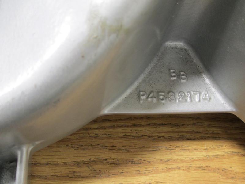

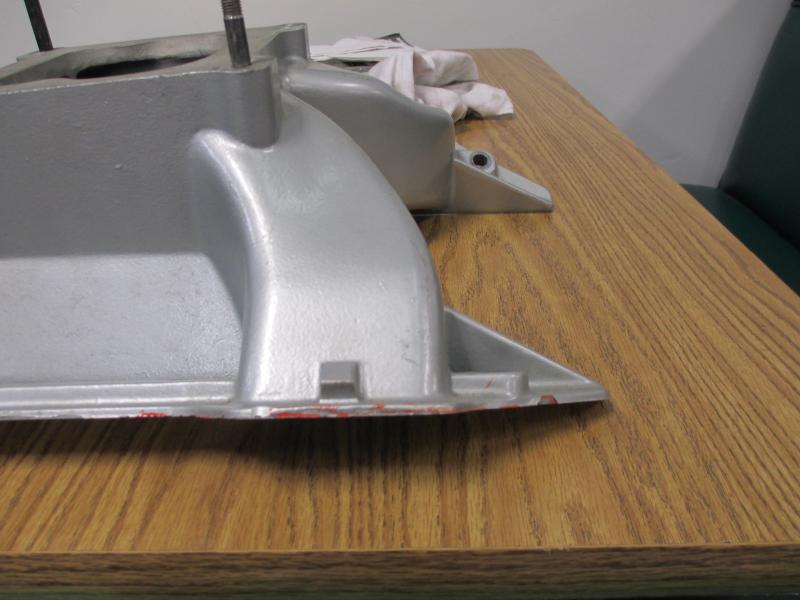

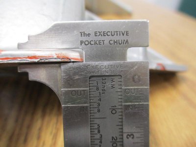

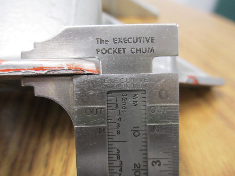

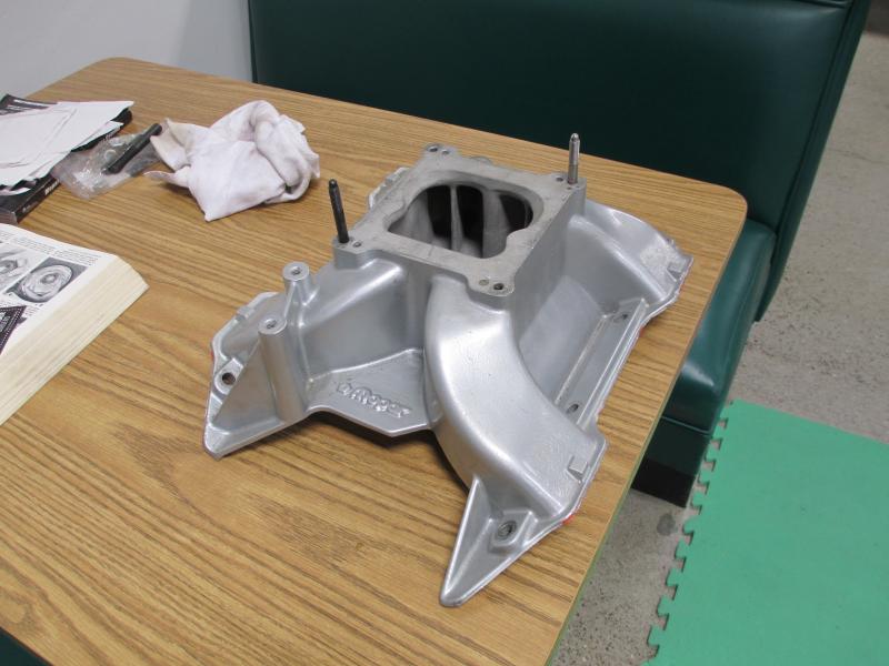

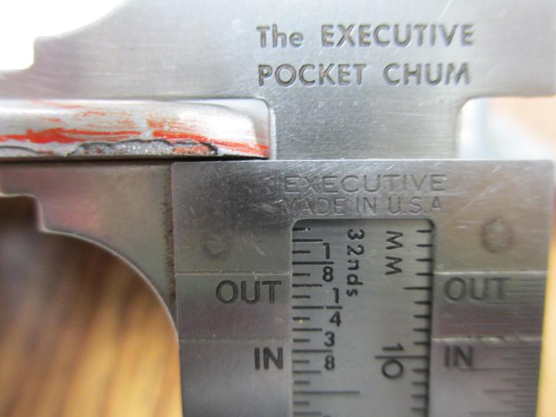

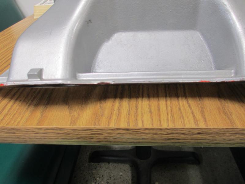

I bought this manifold used and was told it was good, but when it got here it looked too thin on the flange. Can any body tell me that has one if it been milled down. Thanks. IMG_0252.jpgIMG_0251.jpgIMG_0242.jpgIMG_0243.jpgIMG_0244.jpgIMG_0245.jpg

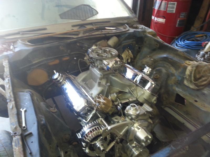

It does look thinner then the one I put on my engine. Here's a pic sorry its not a closer one

Oh its good alright! Good and thin! It looks as if they have milled about .180" off.
Any idea how much a block would be milled to make this a match? I will just try to sell it to someone that is going that direction. Unless you think it's junk.
if you run the steel pan and paper backing gaskets you might be ok.set them all in place and see if your bolt holes still line up.
