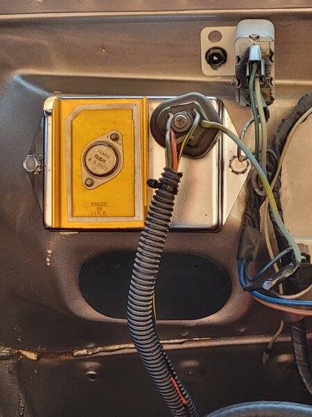

Same deal with a lot of electronics now days. A lot of the guys running Mopar electronic ignition have issues with the new ECU's they buy. It's best to get a good one from @HALIFAXHOPS . He tests every one he sells.
I'm considering switching to a mopar icm except i need the plug in terminal
Hoppy may have some harnesses as well. He knows exactly what coil and ballast to use.
Note Made in USA and the RCA transistor. Some use Motorola. Good stuff !!!

Since I have an msd box that has failed twice I am inclined to get rid of it and go back to oem stuff. My distributor is magnetic pickup,I believe 75 mopar vintage ,and an accel coil. I can go 2 ways. Install an ecm/icm and wire it to my distributor but I do not have the special plug for the icm/ecm. Secondly,I can buy a complete kit including magnetic distributor,icm/ecm,and wiring and be done using my Accel coil.
