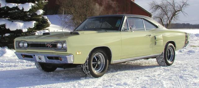

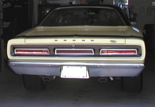

Yes, thats what I have on my R/T. Rears are 15x10's with 295/50/15's. Fronts are 15x7 or 8's, (I'll check further, I have that data written down somewhere, but can't find it right now.) with 235/60/15's.
Backspacing is either 4.5" or 4.75" on rears, again I don't recall exactly the front backspacing, but I'll get back to you when I dig up the specs on what I bought.
A word of caution: You didn't specify Dodge or Plymouth, you just said 'B' body. I am fairly sure that the Plymouth rear wheelwell is slightly smaller (maybe a 1/2" or so) than the Dodge, due to the contour of the quarter panel. Mine of course, is on the Dodge version and the 295's are about as big as I would want to safely go. They might be tight on a Plymouth. Also, if I were to do it over again, I might go down one size (225's) on the fronts. Some very slight rubbing on the frame rails during full stop turns.

Found my specs on the wheels:
Fronts - 15x7" with 4 1/4" backspacing.
Rears - 15x10" with 5" backspacing.
Also, obviously this is on a '69 Dodge 'B' body. Not sure what year/make/model you are working with.

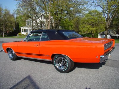

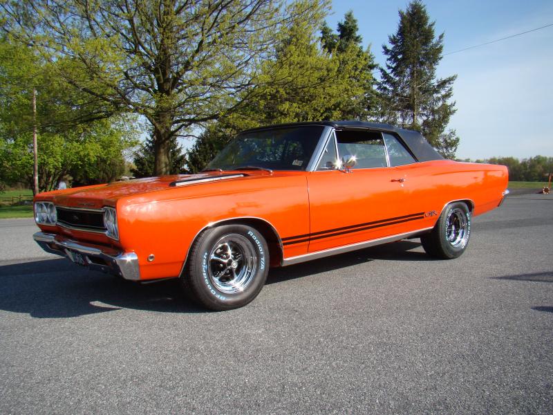

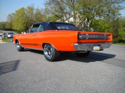

M3 Concert 019.jpgM3 Concert 018.jpgM3 Concert 015.jpgWell the correct backspacing needed for a Plymouth on a 15x10" wheel is 5 1/2". I purchased some 15x10x5" backspaced wheels, and they worked until I lowered the rear to an acceptable level. Now I am getting a slight rub on sharp turns with the body rolling. I just ordered new wheels with 5 1/2" backspace which will work out fine. The Charger and Coronet does have a wider quarter and will accept the 5" backspacing, but not the Plymouths. This was using a 275/60/15 BF Goodrich tire. Hopefully this will answer someones question I was looking to be answered 5 months ago.

take a look at the post 4 down from this with the canadian flag. You will see pics and info I just poated yesterday. I have 15 X 8 with 4.5 backspacing with P255/60/R15 BF Goodrich on the front and 15 X 10 5.5 backspacing with P295/50/R15 on the rear. I put them on bpoth my 74 Runner and 69 runner and fit with no issues as you can see in the pics. I also have for my 69 runner a pair of P275/60/R15 on 15X10 4.5 backspacing. They are close to the lip and you have to have the air shocks pumped up so that they do not rub. With a 5.5 backspacing they would fit okay as evidenced from my use of the P295/50/R15 which are wider.
