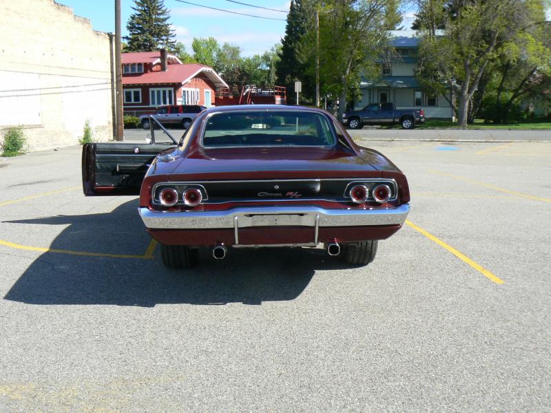

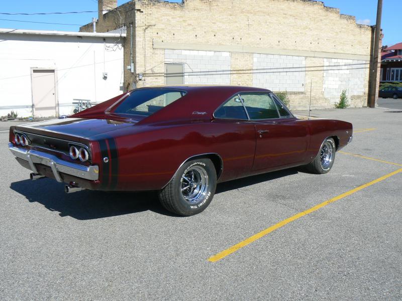

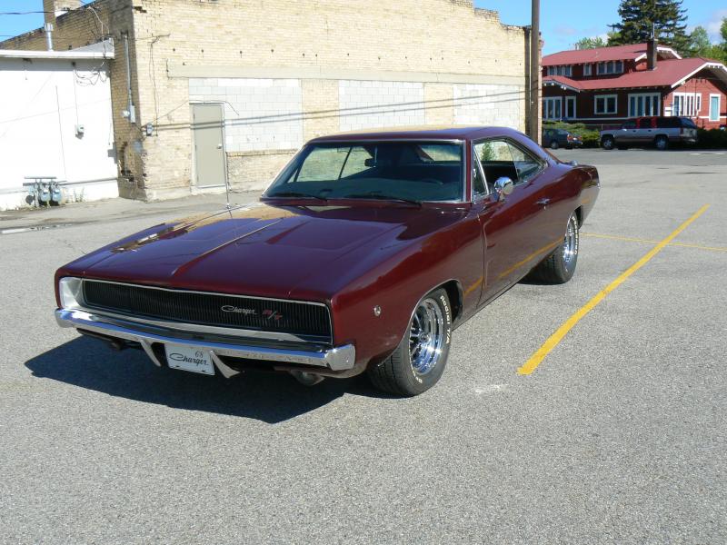

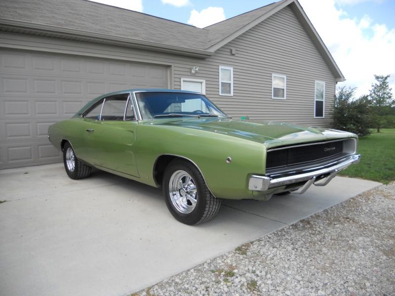

The rears are 275/60/15 and the fronts are 235/60/15 They work fine.
Dear Lord KDTJB, that car is........i can't even find the words. O_O

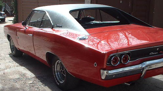

Is that a factory color in 68'?
Are you runnin 15 x 8s with 4.5 BS as well?
Damn that thing looks amazing!!!!!!!!!!!!!!!!
Also, is your suspension sittin pretty close to stock?

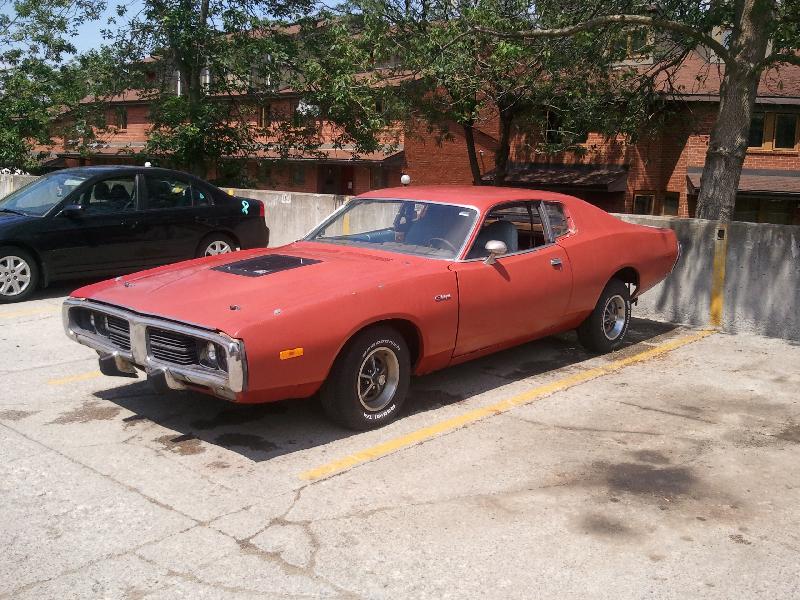

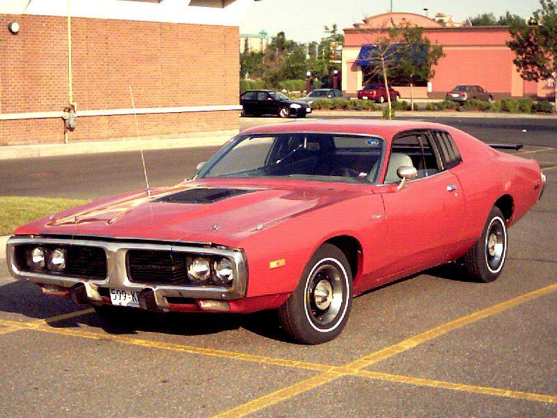

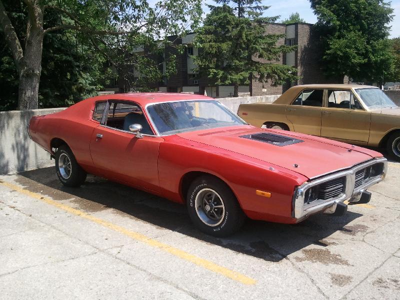

Not a 69, but here is my 74 with 14" (I wish I had 15") Magnum 500's... and an old pic when it had 14" skinny rallies lol
She's REAL purdy Kernal Sanders!

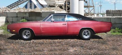

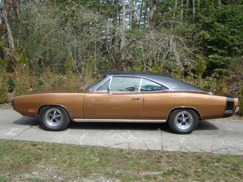

Hello, I've got 15x8 with 275s on all four corners of my 70 Charger and I think it looks good. I know it drives great.

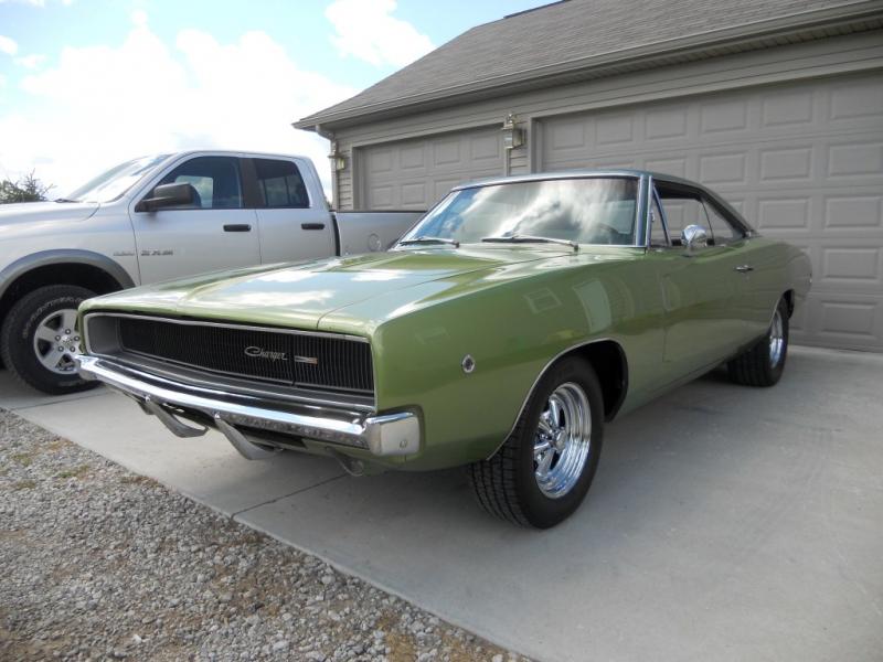

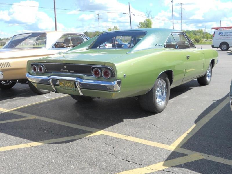

The wheels are 8" with 4 1/2" B.S. That is close to the factoy color as the body man said he could get. Thanks, Kent.

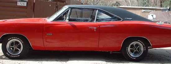

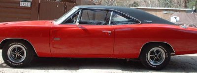

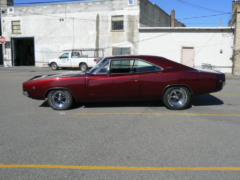

2 (Medium).jpgNot Magnum 500's although I wish And May Pull The Trigger This Summer

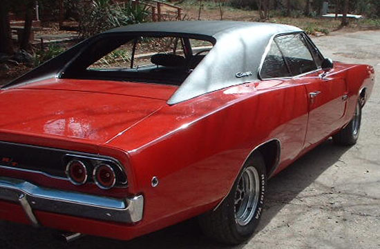

Fronts are 15x7 with BFG 235/60/15 and rears are 15x8 with BFG 275/60/15 no issues and fit great.

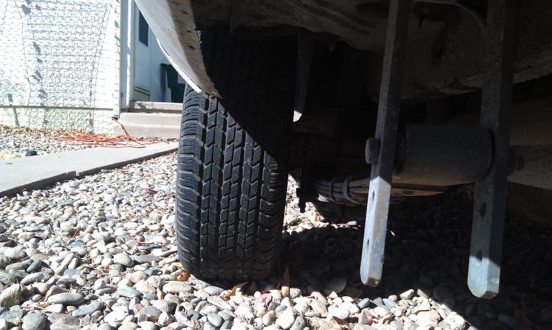

Everybodies' cars look amazing! Thanks for all the replies too. I have determined that I am most likely going to go with 15x8s all around, and I was pretty sure I was gonna go with 295s rear and 245s front, but due to a few recent posts, I am now torn. Any arguements for or against? Also, Anybody know the best place to pick up a set? Local, Paddock/Year One, Ebay? And my bolt pattern with drums is 5 on 4.5 correct? And one last thing (sorry!), what is goin on with the bracket that my leaf spring bolts to? should I just hack off everything that I'm not using? It scrapes speed bumps and they look terrible. I want my car to be as gorgeous as all yours! helppppp!! Thanks guys

Are those Cragar SS'? they look great on that car.is that think green on green on green? Mine was originally forest green metallic with green interior but im not sure what color the top was to start

Yes they are Crager SS But I'm not a big fan of unilug.

I found a rear leaf spring shackle set on ebay that is pretty affordable. its just supposed to be a quick fix for now. I have a couple questions: Is it difficult to replace these shackles? Is this a decent part to install in place of my adjustable shackles and will they fit my Charger?
http://www.ebay.com/itm/390530859258?ssPageName=STRK:MEWAX:IT&_trksid=p3984.m1423.l2649
One more question: Any guesses on how close to stock these will make my car sit, and will it look okay?

Okay guys, thank you all so much for your experiences, advice, and pictures. I have come up with two sizes that I am torn between, and both are on 15 x 8 all aound. I like the look of 295/50 on back with the 245/60 up front, and I also really like the 275/60 back and 235/60 front. But what do you guys think of a 275/60 rear and a 245/60 front? I could save a little bit of money if I went that route, assuming it will look good. From what I gather, the 295/50 will be fatter than the 275/60, correct? Even though it has a shorter sidewall, the 295/50 should be close to the 275/60, but fatter overall?
