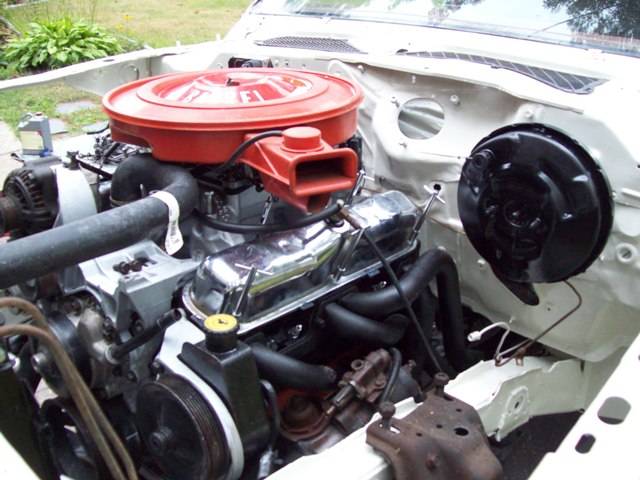

Your welcome. I swapped a '00 - 5.9 into my '79 Magnum with what I wrote above. Backed by a 727 & a 9-1/4 w/3.55's on 245/60/15. An excellent street driver. No cam swap.....yet. A set of EQ/LAX heads or Edelbrock heads are an excellent upgrade for power without breaking the bank. I would also re-use the OE roller lifters on an upgraded cam to suite the build. The OE roller lifters are a little heavier than others, it is a low RPM street car. No big deal. I did this on the wives late model roller 360. I used a Comp Hyd. roller XE with 224 on the intake w/a 904, 8-3/4 - 3.55's and 26 inch tires. A converter restalled to suite. Excellent street car that moves well. Ported heads & 1.6 rockers will follow.
