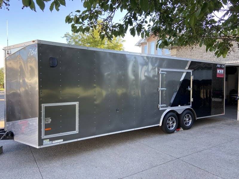

Making and installing enclosed trailer escape door.

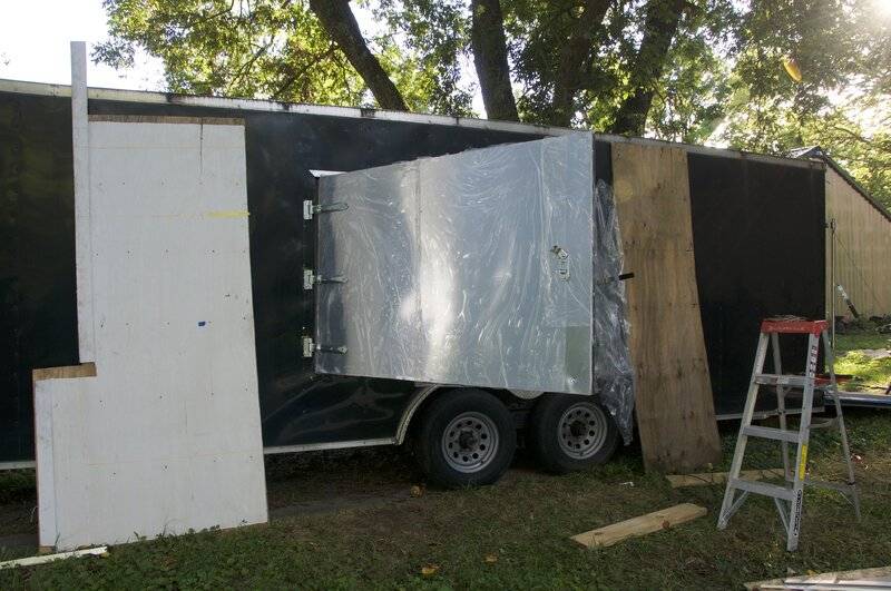

Thanks, but I'm not that smart. I made plenty of mistakes. I didn't want to use the skin I cut out, just didn't want to deal with the ribs. I also don't really care how the exterior looks. If it looks crappy it won't attract attention.

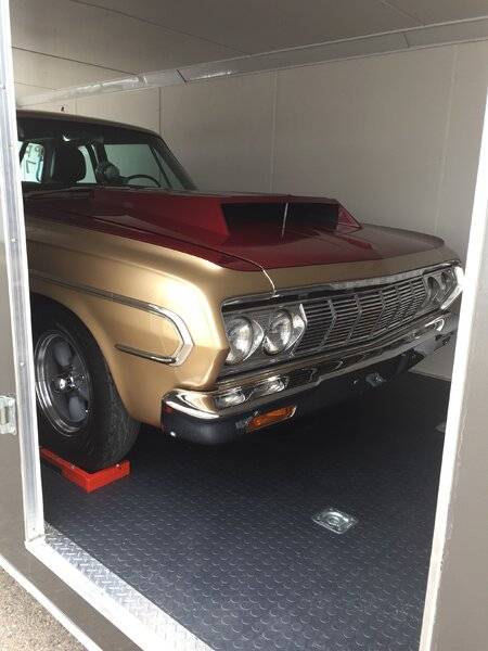

I was so consumed with building the door I didn't stop to think about what you meant by a pillar - you mean the B pillar which doesn't really exist on a Charger or a 'Cuda. Even with both windows open it was still a pain in the *** getting out of there. After getting the shaft from the door lock, I made sure I kept padding in the car to lay over the door opening to get out. I'm not very tall or "big" and it was still an ordeal. I would usually take my shoes off and toss them out the window to the front of the trailer if I couldn't take them off before pulling the car in.
Yep it's a real squeeze. I don't know how Doug does it, it seems he's got a process down pat. For me though and that darned post I have to ride the rail with both front and rear right side tires, then I'm able to open the door, the swing out and slide in/out. Glad those days are now gone.
Orange rail (trip hazard) that I would ride up against
I can’t open the door at all. Just climb thru the window. It’s easy because of my youth, lol

One of my best racing buddies runs a killer 67 Chevelle Post. He too sings the woes of the window pillars and trailer egress. He winches his in. I’ve never really paid attention to how he gets it into Park & brake on, though.
I just winch mine in.
I have zero room to even open my door.
My next trailer will have an escape door.
In response to the location of the trailer door, this is how I look at it: I bought the trailer for the car, not the other way around. I don't give a flying rats rear end if it doesn't look "balanced". We went to a lot of trouble taking measurements while the car was in the trailer to make sure the opening would be in front of the car door hinge and have plenty of room for that 4ft plus door for either a B or E body to open without hitting anything. This door is 4ft high and 6ft long if I haven't mentioned it already.

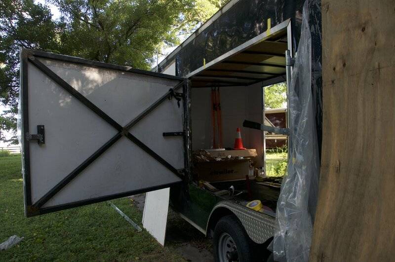

Doing this by myself sucks, by the way. I cut the opening right down to the top of the frame above the wheel well and had to make a custom piece of trim to go over the diamond plate cover. That gave me at least another inch of car door clearance at the bottom.
I didn't bother finding the special trim used on trailers because it's almost impossible to get - the trailer builders apparently have exclusive extruded bar produced and I couldn't find it anywhere even on trailer supply websites. So I had to CRACKER RIG :) what I needed with available stock aluminum.

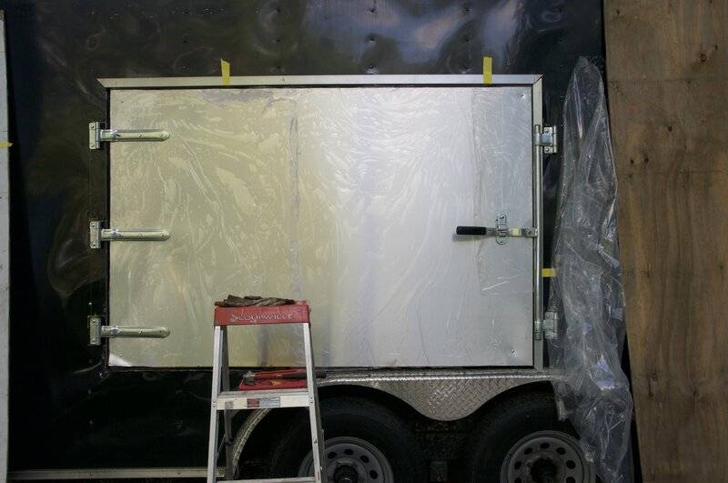

Installing the angle trim:
(Yes I bent the left bottom corner of my nice aluminum skin putting it in the opening and catching the edge.)

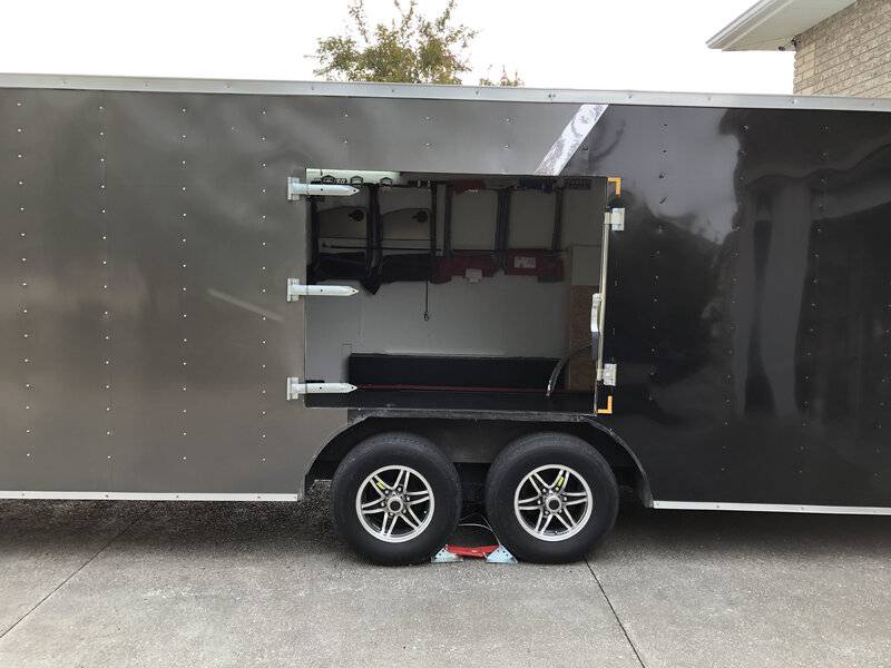

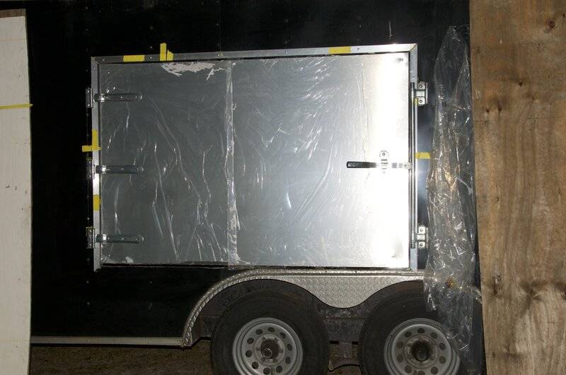

It works:

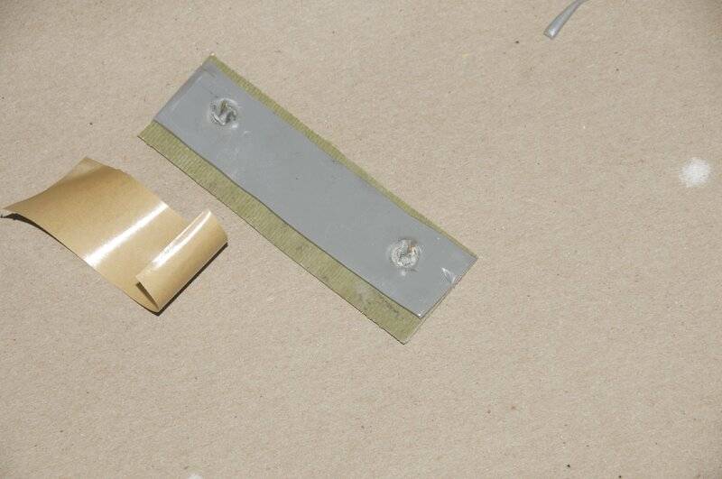

I had to make shims for the bar lock. I used sheet fiber glass and put a strip of butyl tape on the side that goes against the trailer.

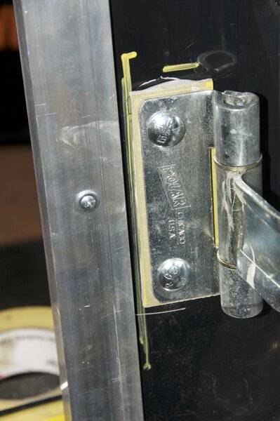

Where did you get the hinges?
I bought my hinges from a local trailer sales store along with the trailer door cam lock assembly. They also had the overhead drip rail on the shelf so I bought one of those too.

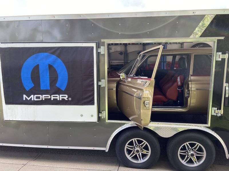

So here’s the door in operation, works terrific and this was one project worth every minute.
Door fully open, getting in and out is a snap now.

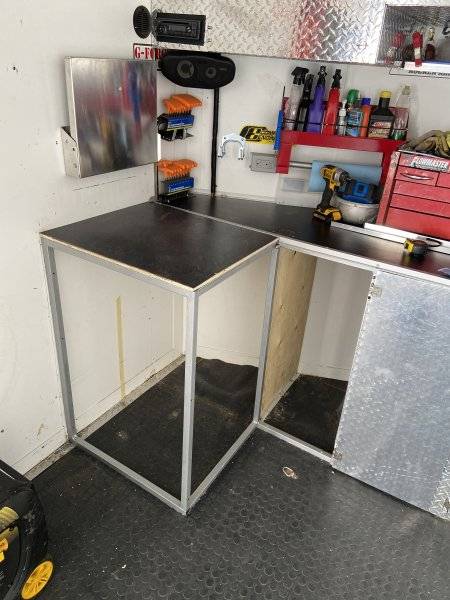

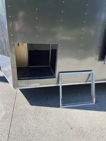

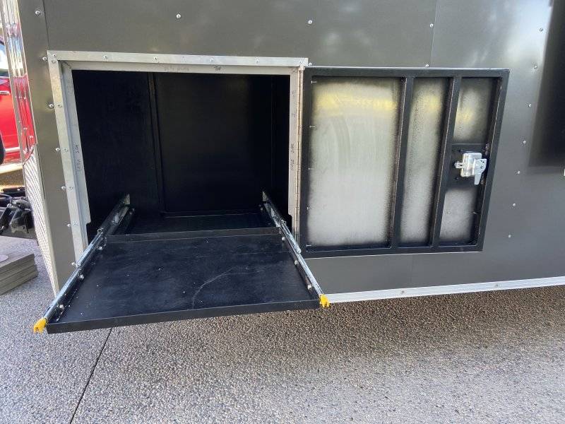

A new project has since gotten underway, that being a Generator door and slide out. And I will say that job was a lot of work! It started off with the inside bench getting a makeover.
Once that was done it was time to make a door frame and hole.

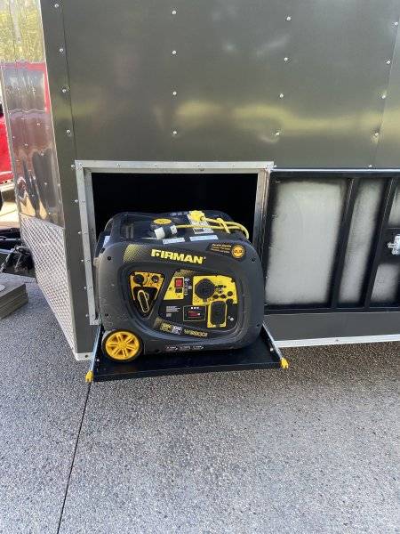

Next came making a platform, sliders, building a door. Sounds easy but that was all very time consuming.
A shot with the generator in place. Sliders are 500 lb rating so there’s some overkill built in.
Project Complete

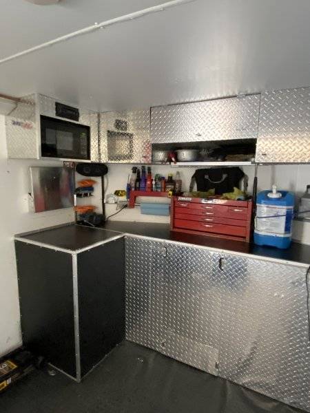

A shot of the inside finished up. Ended up building some more top cabinet space, relocated the radio and installed a microwave.
A new project has since gotten underway, that being a Generator door and slide out. And I will say that job was a lot of work! It started off with the inside bench getting a makeover. View attachment 1322207
Project Complete
Project Complete
