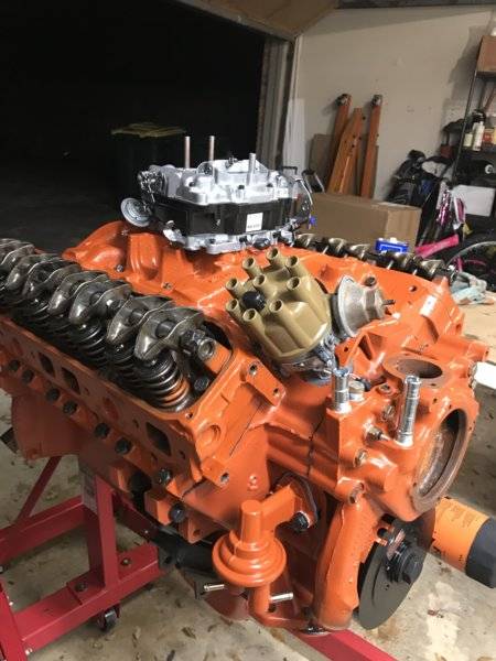

Thanks for all the advice guys. Now Santa needs to bring some headers and valve covers.

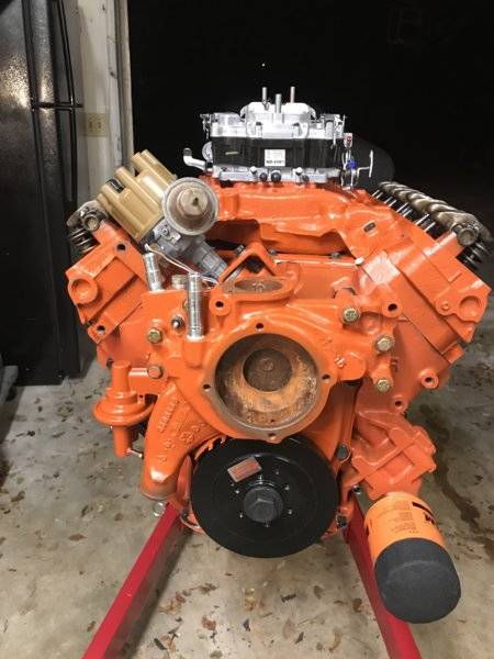

Just curious, is that the side your lower radiator hose is on for your radiator? (Looking at your water pump housing)
That water pump housing is for a truck or RV I do believe. And if you stick this engine in a car the lower hose will need to be on the driver side. Thats the same housing my RV 440 had.
Haha. I knew the housing question was coming. My Road Runner is actually a 318 Belvedere car with AC. It has the lower pump hose on the passenger side and a 26 inch radiator so this worked for me. As for the Fram, it’s just for engine break-in.
DOh.. Didnt think of that.
I was hoping that was your answer...on both questions.
