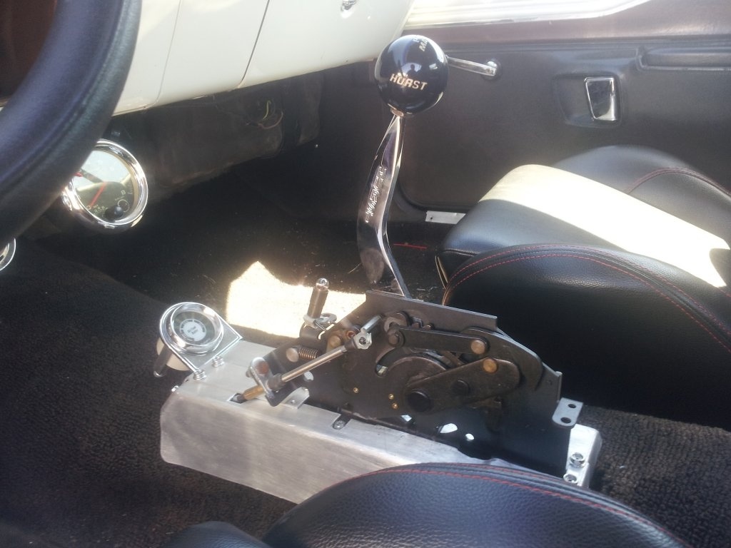

I want to replace my valvebody to a manual one. Can I use this shifter or do I need to buy a shifter aswell? If I can use my shifter what do you recommend? If not what are your suggestions for manual valvebody and shifter? I have 727 a transmission.

That shifter will work. I prefer the Turbo Action Cheetah shifter and ratchet shifter such as yours willl suffice.

I use the Turbo action reverse manual valve body in my 63 and since I use a 1970 auto 727 trans I use the B & M Pro Stick shifter and I love it. It dont cost a ton and its so simple to use. You can use your shifter and you can go with a forward or reverse valve body. I prefer reverse since I race my car some and I like pulling the shifter back towards me when racing. I am not a fan of the ratchet type shifters myself and thats one reason I like the Pro Stick so much since its so easy to use and you know what gear your in when looking at the shifter. Ron
