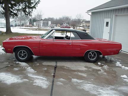

Oh and btw I'd love to see some pics of that 70 Sat convert. I used to have a 383 / 727 myself, but a big block 4 speed convert is cool as hell.

Hey Tallhair- I had a relative of your Sat vert, but mine was a 318/727 ( sold it to buy my 70 RR, which i regret but only have one garage). My first mopar (my college car) was also a 70 Sat vert, 318/ 3 on the tree/ manual steering/ manual brakes. When you're 20 years old, you don't even consider the issue of manual vs power steering.
