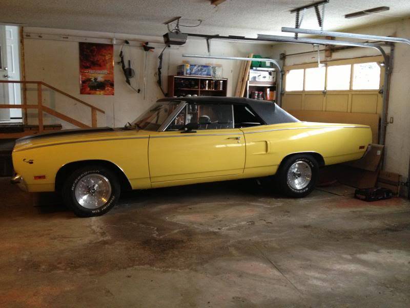

Hoping someone could throw out some help - I'm doing an engine / tranny swap in my '70 Satellite convertible, going from a 383 auto to a 440 4 speed. I had been thinking about ditching the power steering in favour of manual steering, and since I have the engine bay all open, I guess now would be the best time to do it.
Here's my question - Has anyone out there done this, and are they happier with manual steering? Anyone have any pros and cons they could share?

" I would love to see some pics of that 70 convert now though "...
Here's the latest shot I have of the car - taken just before winter hibernation and the yanking of the 383.
...And yes, I DO plan to go with a manual steering box. I'm going to keep the power steering setup just in case, but I suspect I'll be happier with manual. I actually preferred it on the other car, even though it was a dead power steering unit. Parallel parking and tight turns weren't too much of a big deal, I found. No way in hell would I go with manual brakes, though.
