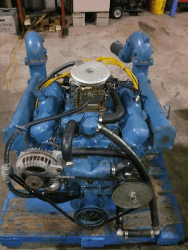

Can I ask why they are not happy? The boat next to my father's when I was young was a 30ft Luhrs and had twin 318's and literally had the same charging system as car. They looked just like this engine. My father's boat had twin 454's which used a very similar automotive charging system then he converted to twin Cat 3208's which used similar charging. I ask because I am always willing to learn as I never heard it being an issue.

Can I ask why they are not happy? The boat next to my father's when I was young was a 30ft Luhrs and had twin 318's and literally had the same charging system as car. They looked just like this engine. My father's boat had twin 454's which used a very similar automotive charging system until he converted to twin Cat 3208's. I ask because I am always willing to learn as I never heard it being an issue.
