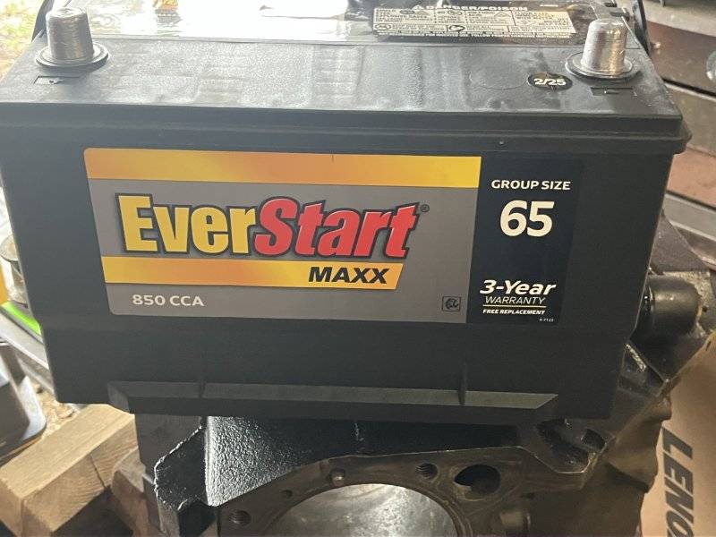

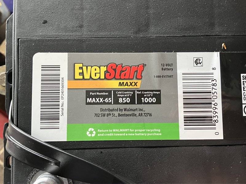

Below are pics of the Walmart battery I bought, $139.
I chose it over the group 27 because it had higher CCA.
It’s about 5lb lighter than the old battery, just a guess, I should have weighed it.
I had to make a little change to the tray since it is wider than the old one but no big deal.
I also bought new stud terminals.
Once I got it installed it turned the engine over very fast, so the as new performance is good. We will see how long it lasts.
