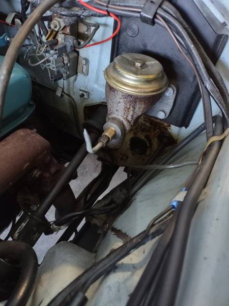

I disconnected the old single pot master today. I went into the car and pulled the brake pedal backwards, and felt the pushrod pop out of the master. I then removed the four nuts under the dashboard holding the master, and my hands look like mincemeat. When I went under the hood and tried to pull the master out it seems to be hung up. Is there something else I need to remove, or could the studs just be jammed in the support plate?

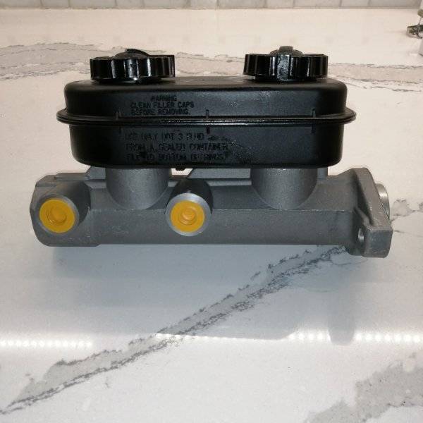

I'd recommend changing to a dual-port MC.

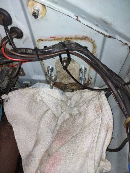

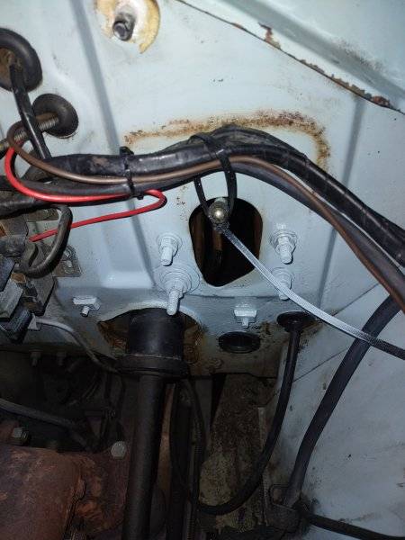

OK I hate to admit it but I got back under the dash today and found the problem. I knew I had removed the 4 nuts. Turned out I removed one of the nuts for the reinforcement plate and left the passenger bottom nut on the master. Needless to say when I was prying on the master I bent the corner of the bracket. Oh well, I took the rest of the nuts off and now I can detail the reinforcement plate and paint the firewall underneath where leaking brake fluid had messed up the paint. I guess I am used to working on A bodies without the plate. That is my excuse and I am sticking with it.

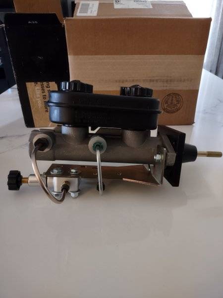

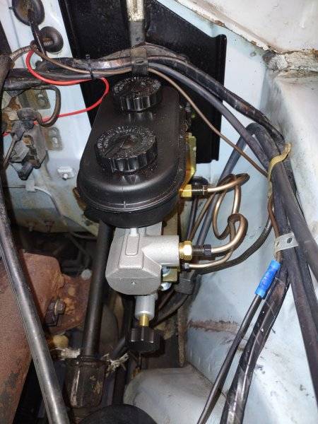

I have already mocked up the new master and adapter plate. I used a universal bracket to mount the adjustable proportioning valve directly underneath the master.
I got the firewall straightened out and used a series of spacers and washers to pull the inner support bracket back into shape. I then cleaned up the rust under the old master and gave it a shot of paint.
