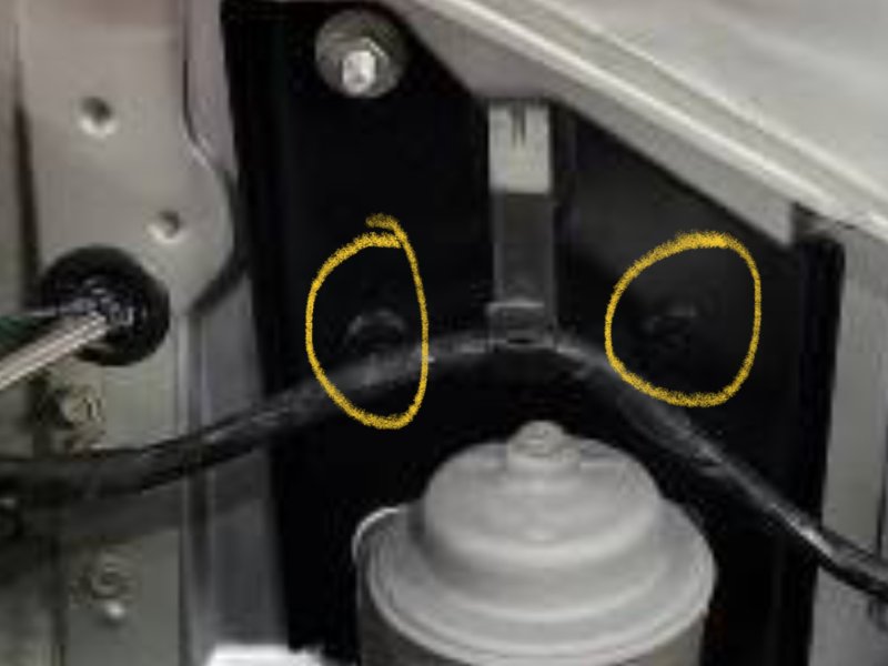

Hi Guy's,
It's been a few years since I needed your all's help but I am having problems on how to remove the master cylinder reinforcement plate on my 69 Superbee with Manual drum brakes. I
have the nut off on the engine side but whatever is holding it on the inside, I can't seem to locate those nuts. Mostly everything is out on the inside near it but the pedal assembly. I hope
it's not tack welded on and hope all I really have to do is pry it off with a pry bar. Thanks, Dave
I believe it is the two "Upper" pedal assy bracket studs. Basically, a bitch to get to...
I haven't found anything under the dash and up near the firewall that isn't a bitch to get to! That is about where those should be.
There are two studs above master, very easy to locate because the heads are through the plate. look for the round circles with spiral grooves, kinds like a record.
I know about those, just try to get to the nuts behind them to take it off. I do believe they are the two top holding the pedal assembly on. Thank you, Dave
LOL this **** cracks me up. Well sorry the are a bitch to get to, but those are them.
grind off the heads then and move forward.

I got it off. Them damn nuts were directly above the pedal assembly and all I could do is feel them and I could barely se them.
