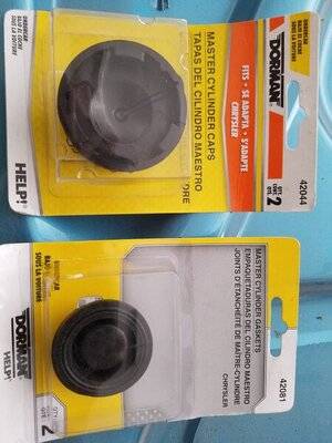

I'm running Dr Diffs 15/16 aluminum masters on all 3 of my cars. Work great but you might as well figure buying Dorman seals and caps right away.
Please tell us more about this. I have this aluminum MC from Dr. Diff. Seems like there is always a bit of fluid on top to wipe off when I open my hood. Is there a known issue with these??
Yes. The supplied caps don't work
well as I've had the same problem.
Advance Auto parts #42053 are
the solution.
These are the caps and seals that Cass told me to buy. I have used them on several of his master cylinders.
Sounds like there is a known issue with the cylinders that should be, or have been, covered by a warranty. But, I have had mine for over a year now. Anyway, I would think Dr. Diff should not sell a defective product like this.... Thanks
