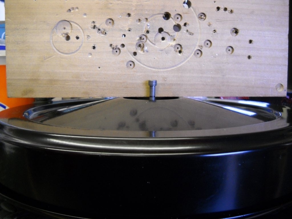

Can someone with a max wedge air cleaner measure it for me???
I am looking for the height of the air cleaner from where the base rests on the carburetor...
I am worried about hood clearance and hate to spend $450 on air cleaners and not have them fit.
I have a 62 Dart, with an original '64 Stage 3 cross ram, 750 Edelbrocks, but I have the Victor Max Wedge Heads which raise the intake about 3/4" from the stock location. The underhood bracing is removed as well. I measured the best I could from the carb to the hood and I there is 2 3/4"...
A picture with the measurement would be greatly appriciated!!

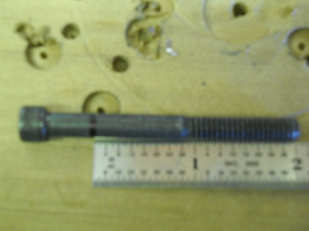

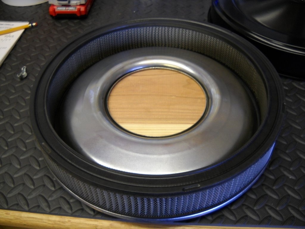

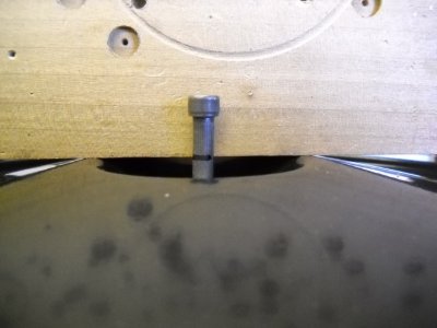

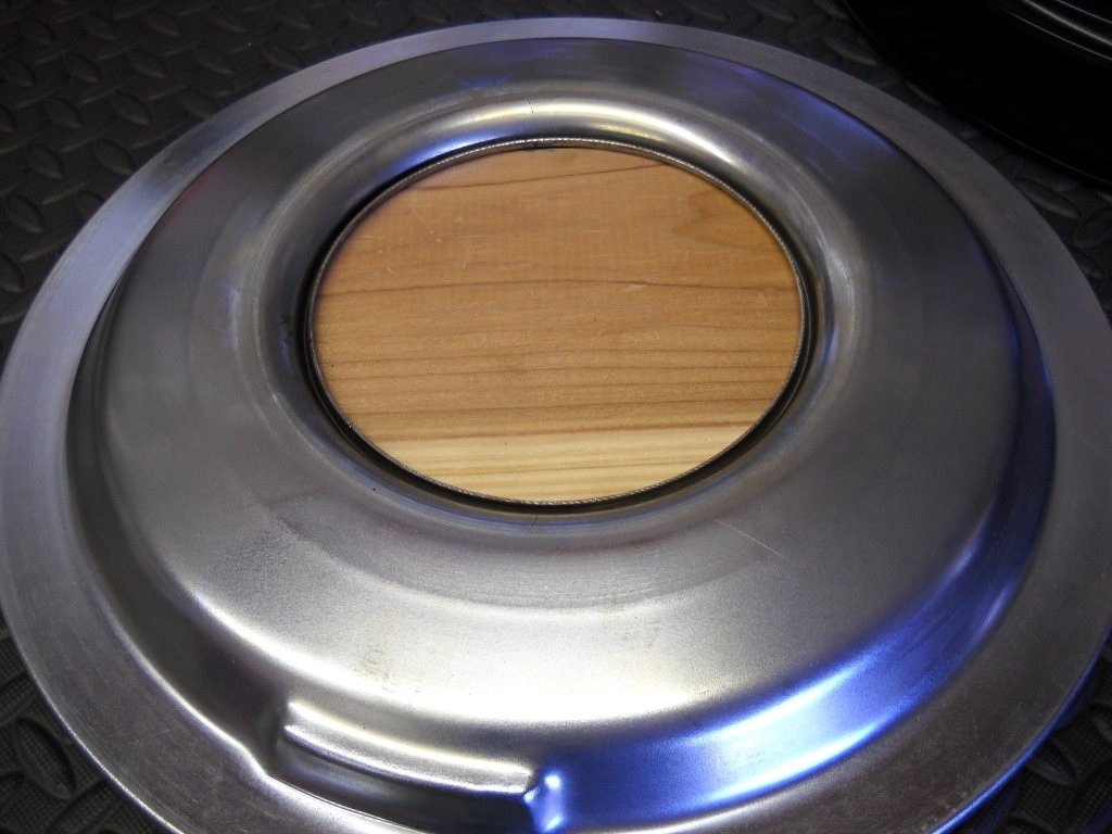

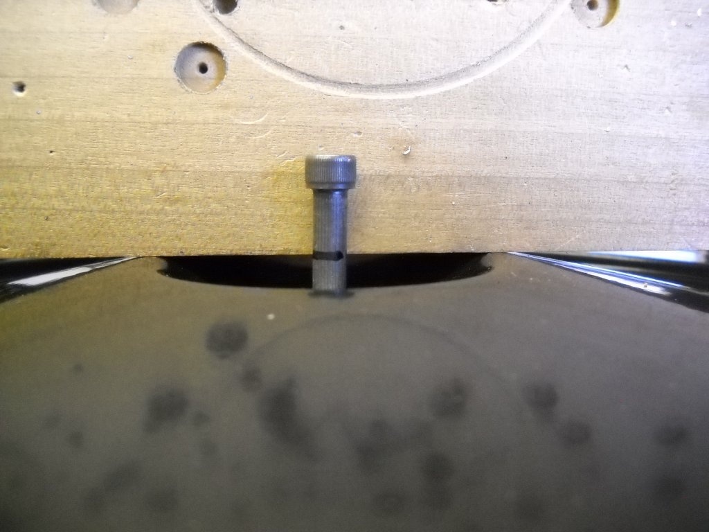

Here you go: The wood block is representing the carburetor flange. From the carb flange to the tallest part of the air cleaner is exactly 2", not counting the stud or wing nut.
