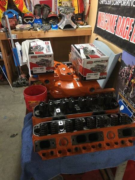

no problem,,bought 2 650 cfm #1905 avs2's yesterday from autozone,,they were 25.00 a carb less than summit! the principal's sound since they all basicly tune the same. so its now a matter of getting the strip kits for them since what i can find my carter 201 kits wont work ?

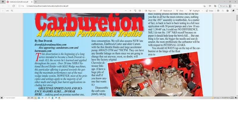

what with positive fin angles..modern technology, ya gotta love it. and this multi-page instruction manual from dvorak on the max wedge tuning was money well spent,, iwas just wondering if anybody had any hands on experiance with these new carbs other than the rumor mill called the internet,.thanks !
I would like to read that Dvorak manual! Where'd ya get it?
chrysler power magazine,,july 2012 issue. i have it in pdf form but i dont think i can unpack it here to display..its not a photo. Or u can get it directly from there website as a download. its only a dollar. if somebody here knows how to show the pdf here i will do it for free.
https://cpwebstore.com/Magazines/Best-of-CP
Thanks Stage 3!!! I'm sure I have that magazine, the trick will be to find it!
Keep trying to figure out how to post it here, if you can. Thanks again!

i read they r 3 step vs the older afb's which r 2 step,,rumor has it u can use the 2 step units as long as u use the corresponding jets..trying to clear my work bench so i can unbox them and take a good look..thanks.

its flat. same as my 3705's.
