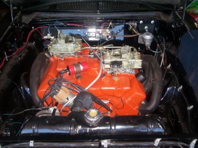

Hi I'm running that set up not the factory but like it 500 strkr block eddy victormax heads with a solid schnieder 580 cam 2 600 holleys tti max exhaust with repro max manifolds 3200 stall conv. 4-30 gears with cheater sliks ,now the tires arnt the best and the gear combo thinking of going to 3-55 and radials but I have no problem on the street and soon as I hit the pump and mash the pedle it has no problems starting and it idles at about 700 rpm temp wise never seen it over 180 and I'm running a stock rad that's from a 300 that's 4 core, I say do it

Hey Squid, can I have your car?
