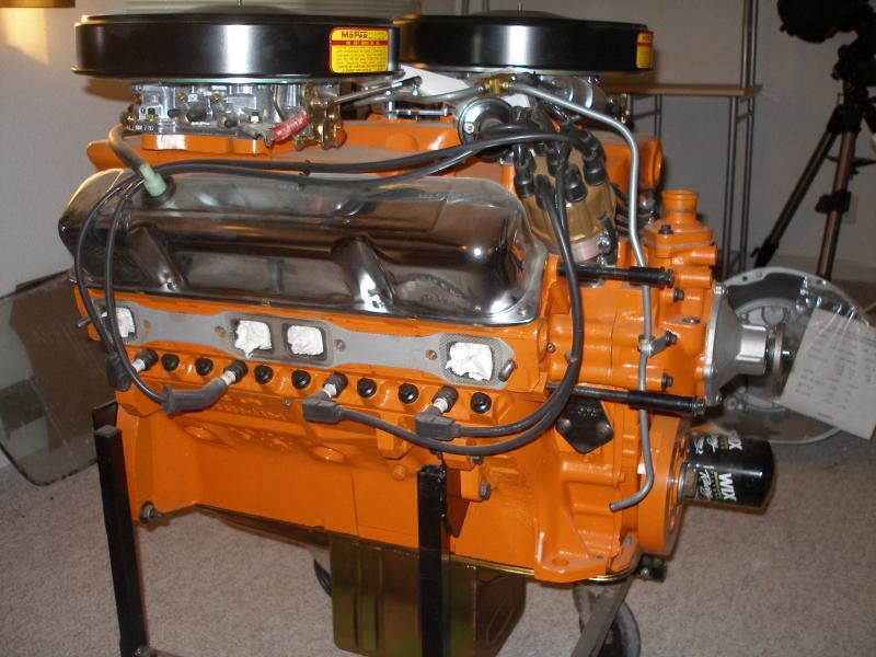

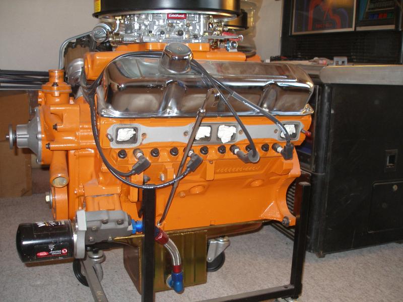

-VERY EXPENSIVE to build, of course, my440 "Max Wedge" I have $2,000 in my #452 heads alone.
Do what I did:
A 440 "Based" Max Wedge style engine. LOOKS IDENTICAL
And yes, it has more HP than my "stock" 1970 Hemi.

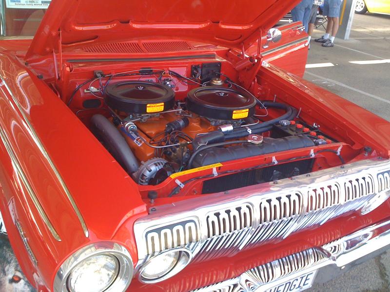

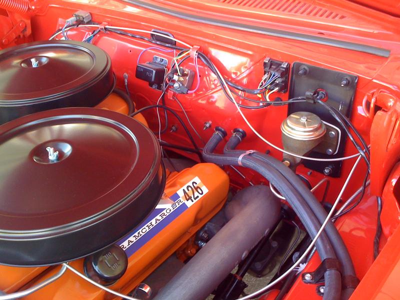

My BUD has a Real One
See pics below.
The engine needs to idle for 15 min or so before he can drive it.
And then it is easily stalled and difficult to get running again.
This engine is designed to be RUN at W.O.T. only (Wide Open Throttle)
