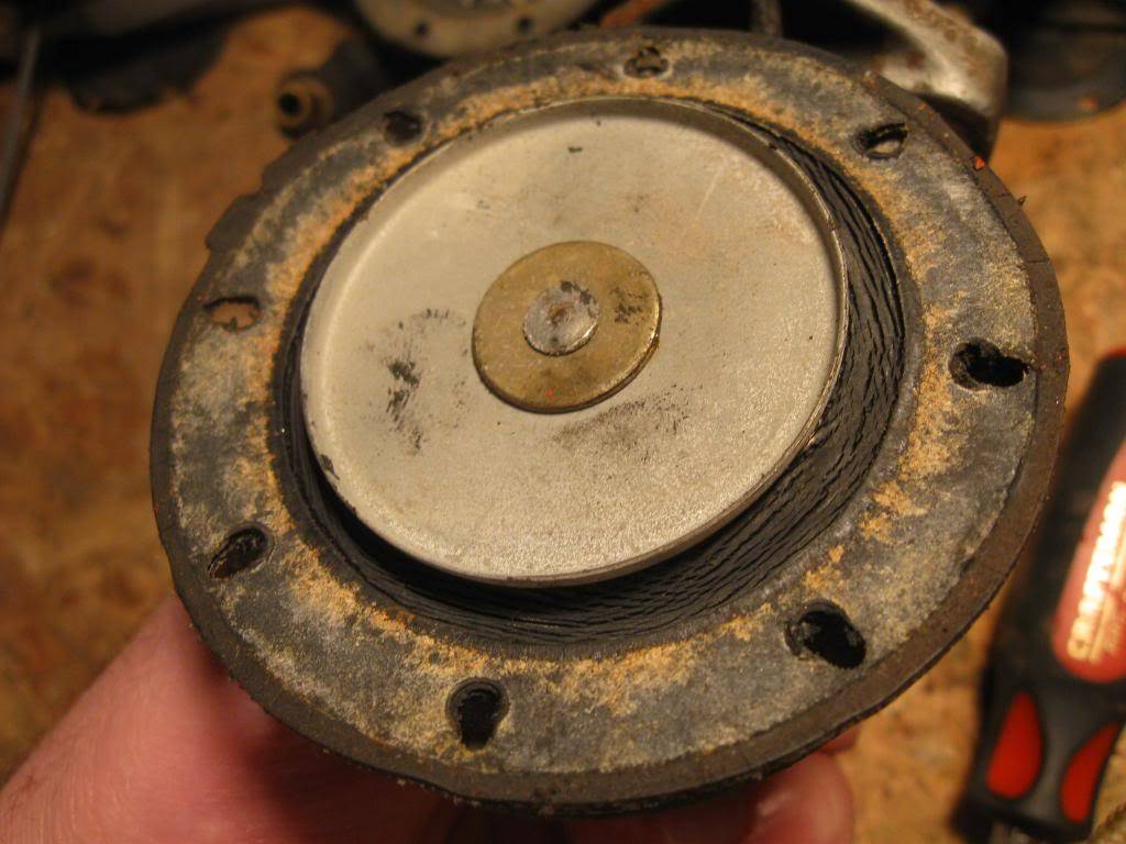

My original M6903 was from '89 and it took a dump last spring. Figured I just order a rebuild kit for $40 and be on my way. Wrong, the diaphragm in the rebuild kit was no where close to fitting. Sent it back and bought another M6903. Of course I was the first one to have that problem.
i'm surprised that pump is leaking past the diaphragm. i'd try looking at the screws to see if any are loose. the edelbrock mechanical is a carter 6903 with a few mods. i like 6903's and never had one fail. the rebuild kits that mancini sells are junk, don't buy them!

don't think there any rebuild kits. i've got one thats been on the car since about '85; still pumping good. never had one break. they're not super complicated to take apart and diagnose.
Yes, they are simple, have seen videos and threads on rebuilding them with new valves and diaphrams. So when mine died after 24 years figured a kit would take care of it. Not so much. Pump was $36 back in '89, now they are $100. Just a little inflation.
Figured I had good luck with the old one might as well give it another go.

you sure got your money's worth out of that one! i'd just get a new one and move on. you might save the old one for spare parts.
